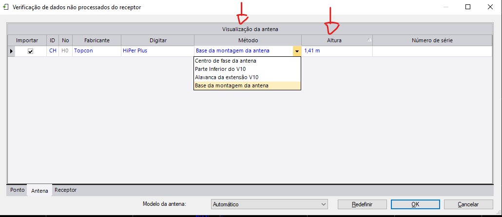

In TBC, there is no specific option for slant height because it is already incorporated in the measurement type you choose. If measuring to the lever, it allows for the slant... T/A manual describes it , TBC uses that information to calculate the height relative to the ARP (Antenna Reference Point).

Good morning everybody!
I'm starting to use TBC as processing software.
My question is very simple.
When adding a base in the TBC we must change the data and in the HEIGHT option I would like to opt for SLANT or VERTICAL. How do I do this?
Regarding the METHODS, what would these 4 options be?
Thank you very much
