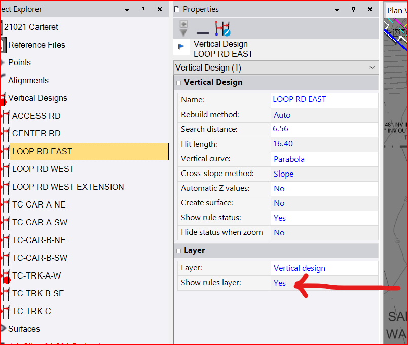

    Hello @Markku Alanko - one annoying issue is, every time the Edit VD command is called by the user, the Vertical Design layer turns off. Then, the only way to get the rules to show is to, of course, turn the layer back on having first switched back to the View Filter, and then rebuild the VD. That's a lot of steps before making any edits. It seems pretty simple but this becomes very very tedious and a production zapping process when many edits are required.  Thanks​

    Turns out I missed a setting in the Properties Pane. Setting the property to yes eliminates the annoying behavior of the rules layer shutting off every time the Edit VD command is selected.
    Thanks @Ed Levandoski and SiTech MetroNorthEast.
