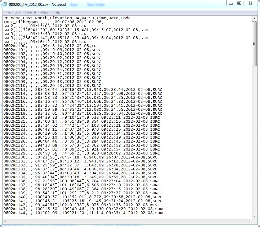

I know Leica is able to store date and time with each surveyed point.
I use Trimble and a few years ago , I needed a report for date and time.
See the attached style sheet. Its a bit of an antiquated way of getting date and time but it works.
So basically all the surveyed points do have a time stamp and it would be quite easy for TBC it display this type of info.
