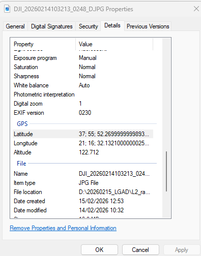

    Hello. I am using the latest TBC and trying to ppk process some DJI L2 missions. I get a 100 fixed 0-5 cm solution. What I am not sure of is whether the results refer to the camera photo center or to the antenna phase center. I have significant differences in the results compared with the rtk solution's coordinates. EG, take a look at two screenshots, one from the TBC ppk solution and one from an image properties (I was rtk fix when I was captured)

    Maybe I wasn't clear, but I didn't want to process lidar data in TBC. I am done with DJI Terra. What I want is to process the ppk and get photo coordinates so I can process them in AgiSoft Metashape. DJI Terra photogrammetry is not free. Only lidar. And yes, you can also export an Ortho from there, but without any control. TBC supports the L2 Sensor for photogrammetry PPK. Like it does with Mavic. It reads all the files. What I am not sure of is whether it applies corrections from the DJI antenna to the DJI camera center.

    Understood. It's likely due to a step missing in DJI Terra. When you bring in your flight folder(s) in to DJI Terra, you need to tap the gear to adjust the base station center point. Unless, and only if, you explicitly used a corrected (VRS or base/rover) coordinate in the field and are doing RTK versus PPK, you don't need to modify the coords in DJI Terra. If you simply turned on your own base or DJI DRTK2 base but are of autonomous (no corrections) quality, the X, Y, and Z need to be updated in DJI terra. Finally, you likely need to add the 1.8m back into the altitude field ellipsoid height value. DJI Terra, unlike most software packages that perform RTK/PPK adjustments, DJI Terra expects that the base z value is at the phase center (APC) of the receiver.
