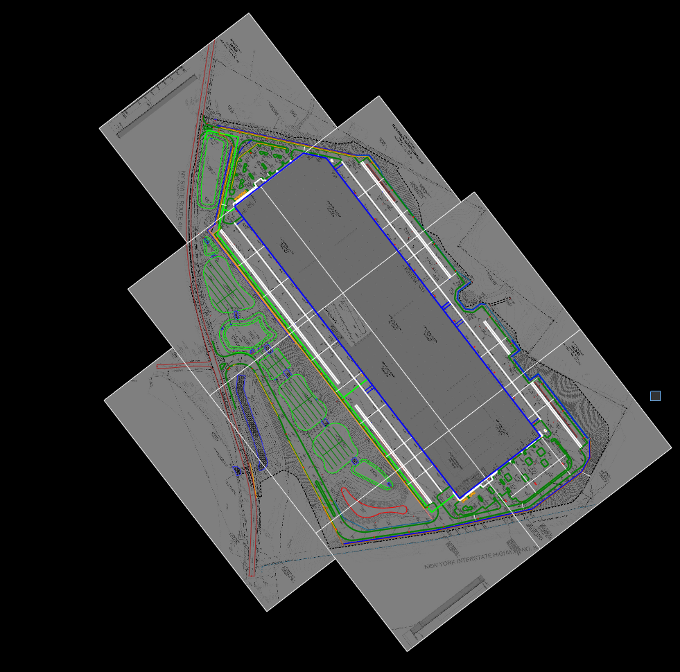

    In summary:
    [3] and [5] appeared after switching the display style.
    [6] appeared immediatly as expected.

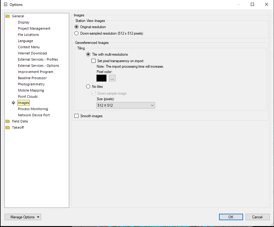

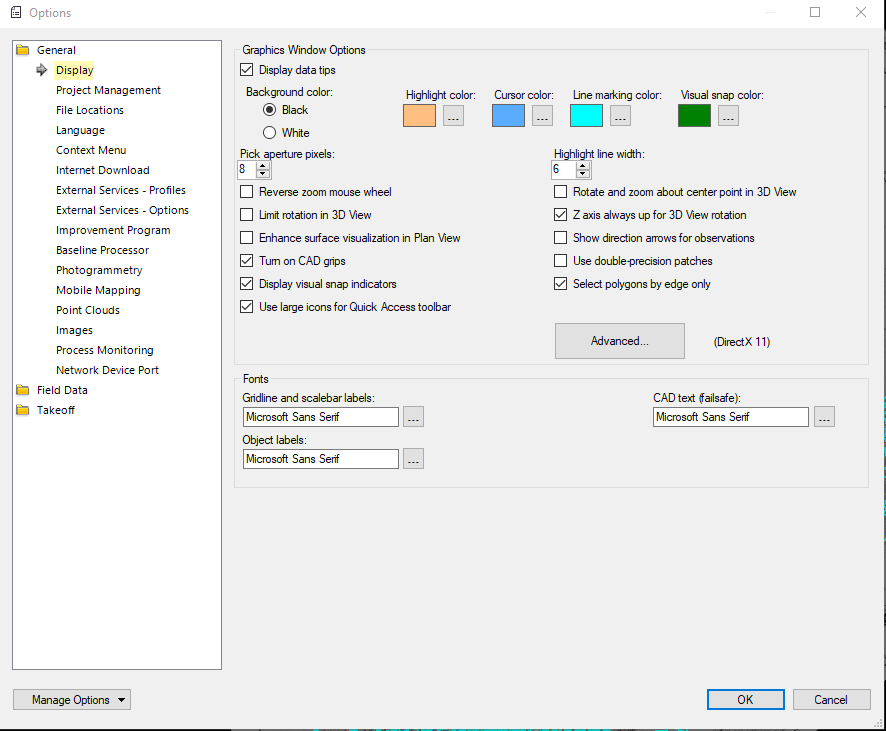

    I would have to have the project Richard to take a look. Maybe it is to the Support - Options use Double Precision Patches setting - try changing that. Could also be to do with the way the images are being tiled - support Options Images - try changing the way the tiling is working and then change it back - that will force the images to retile and maybe that will fix the issue - failing that please share the project so I can take a look
