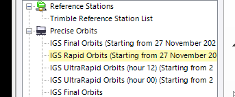

At the end of last year IGS adopted a new reference frame called IGS20 as the basis for their products (https://igs.org/news/igs20/) and made the switch to new long filenames.
Starting from 27 November 2022 the IGS final, rapid and ultra-rapid products are only available in long filenames.
Trimble have fixed it in 5.81 but we had the same problem since we are still on 5.70.1 so I grabbed the config file from the new version.
I put the attached file in
%APPDATA%\Trimble\Trimble Business Center\37.0 and it gave me the 27 November 2022 download links. It might work in other versions though the last number (37.0) will be different.
