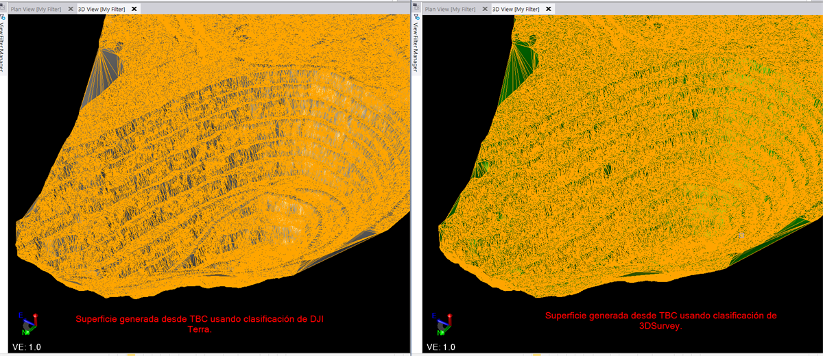

    My question is oriented to the triangulation of the surfaces, is it possible to change the size of the triangles?
    The current workflow is as follows:
    I process the point cloud with the DJI Terra solution, this makes me a more accurate terrain classification than the classification offered by TBC, once the point cloud is generated I import the .las file to TBC and that's where the magic starts to create a surface from the terrain already classified, the detail is that when generating the surface the triangulation is very large and does not respect some points of the terrain.
    I have been trying with other tools to process the point cloud and the triangulation improves significantly then, I do not know if from TBC I can modify the size of the triangles or that would be properly of the software that processes the point cloud?
    I attach an example capture for your reference in case my message is not very clear.
    The size of the triangles change significantly using 3DSurvey
    I appreciate any comments you can give me.

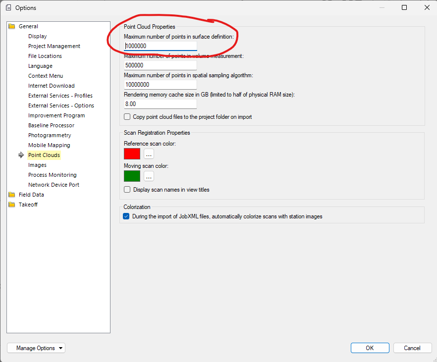

    You can try upping the surface points in the options

    Hi Erik, thank you very much for your answer, I will try and let you know the results.

    I too have encountered this. I am surprised that it is not one of the options when creating the surface.
