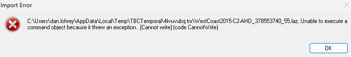

Thanks Michael,
However, we have no issues loading the point clouds locally, the issue is the removal of point clouds when the vce is saved to a LAN drive.
In our case, there is issue with the reading and writing of point cloud files on our LAN as well.
Cheers
Dan

Best to load data from local drive and not use network drives. Even if TBC has no issues reading and writing from them it takes a lot longer from network drives.

We are having import and saving issues with the latest update to TBC.
When we import laser scan data into our projects, we get the below error if we are working on out local network server.
Additionally, we lose any laser scan data that is in a local (c drive project) when saving the vce to our network storage, even after successfully importing while working locally.
Prior to the most recent update, it worked fine no matter where anything was saved to/from and imported from etc.
Any help is appreciated!
~ Dan
