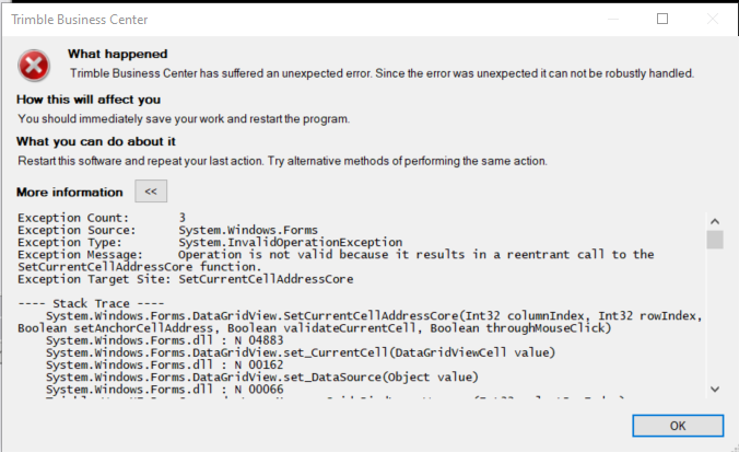

2 - if i run the above code and have the Layer manager open AND filtered then TBC throws an exception on executing
self.currentProject.TransactionManager.AddEndMark(CommandGranularity.Command)
the exeception does not occur when the Layermanager is unfiltered
the layers do get created properly in both cases
