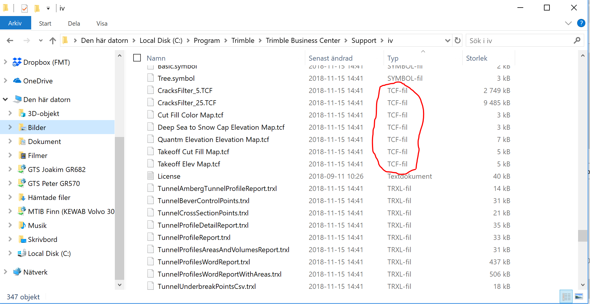

    Fredrik,
    Look here: C:\Program Files\Trimble\Business Center - HCE\Support\iv

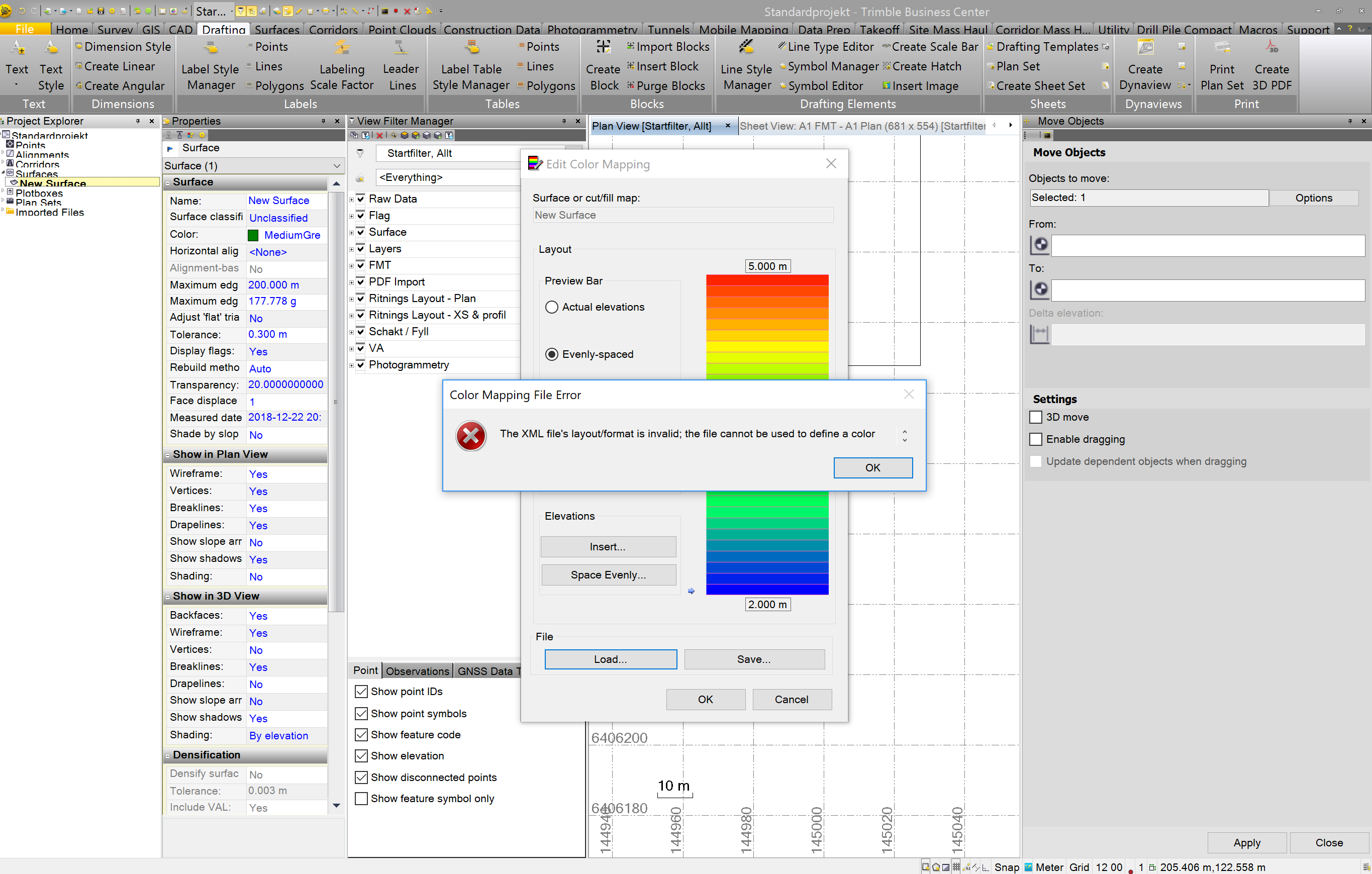

    Thanks.
    Never tried them before so i dont know how they look. But they dont seem to work for me.
    Are the using other colours and not only Blue, green, yellow and red?
