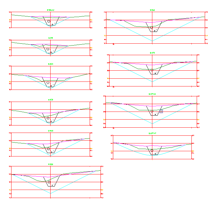

In this example the CAD Cross Sections Look Like This
If you look closer at some of the sections they look like this
And some look like this
The difference is in the Offset Axis - note the lower of the two has a pair of offset labels, yet the first doesn't. This is the main challenge in this particular example. In the second section we could determine Horizontal Scale but in the first section there is no indicator of scale (and that is also the first section type we see - so we would use the values of 36 as the offsets (as they are close to the Grid lines (within the tolerance specified) and because there are no other labels we would select those incorrectly - this would make the sections 72 meters wide and not 20m wide as per the design.
The second issue is all of the little Tick Marks - if selected as Grid Lines - they would duplicate in some cases and in others create new but very short grid lines - this can also be an issue in some cases
The third issue is that when you looked at the 0 offset label, they were all duplicated on the same layer - duplicate data - whether it be labels, grids, station labels etc all create a degree of ambiguity in the process, so spend time cleaning that up. Same for the section profiles - make sure that they are joined correctly and that they have only one instance of each profile.
