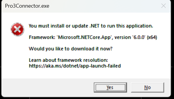

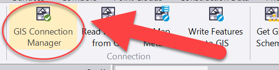

    Microsoft has ceased updates to .NET 6 in November 2024. As a federal govt. employee .NET 6 deployed in software is not working and ceases functioning because .NET 6 is being blocked.  Tested on two different computers, (both running TBC 2024.01 and 2024.1), and when launching the GIS connection Manager tool in the GIS Tab / Connection Group, we get the error below and TBC locks up entirely (must close TBC and restart).
    As MS has ended support, I hope the compiling of the GIS module (maybe this is the only component) could be redone, without .NET 6.   We have 16 licenses of the GIS module spread across and actively being used on an enterprise license server and were stopped cold.
