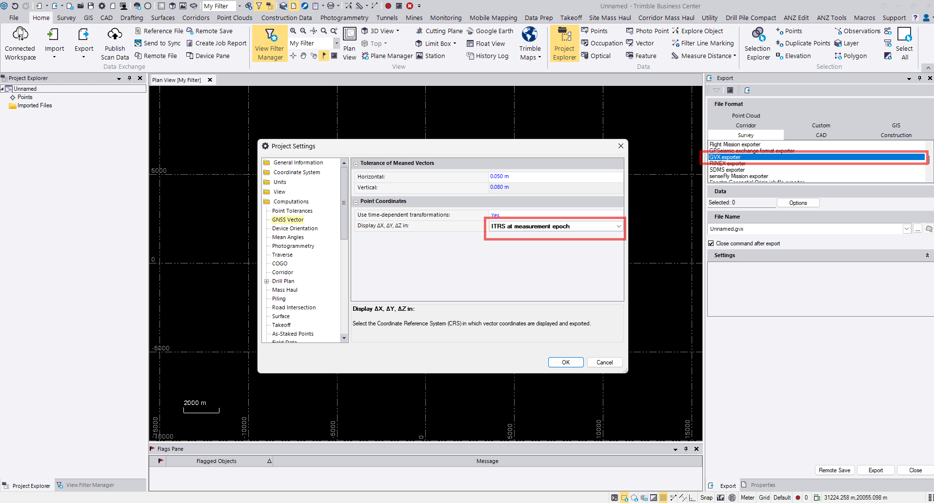

    My company is setting control for a very long watermain project, and we have been tasked with creating an opus project and one of the requirements is providing a .gvx file, we cannot for the life of us figure out how to either get it out of the data collector or export it from TBC. Does anybody have any tips and tricks. We have .TO4 files from previous projects that we have imported into TBC and then export as a .gvx with no luck.

    Alec - TBC should allow a user to export GVX files under Export - Survey - GVX exporter. I believe you will also want to change the Project Setting - Computation - GNSS Vector - Point coordinate - Display delta x, y, z, to ITRS at measurement epoch. This setting should have been made available in 2024.10.
