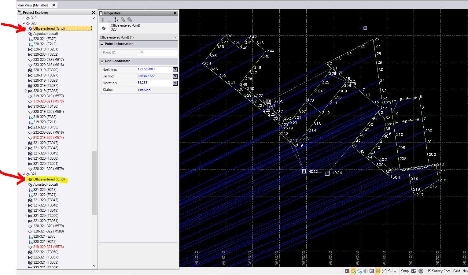

    Is there a way of selecting all "Office entered" coordinates in a TBC project? See screenshot below. Thank you.

    I'm not trying to select points.
    I want to select office entered coordinates. These do not appear in the selection explorer because these are not in the JOB files. But thanks for replying.

    You keep talking about points.
    I'm not talking about points.
    Try this so you can see what I'm talking about.
    Import a JOB file. Click on any point and add a coordinate. You'll see that coordinate will be labeled as an office entered coordinate associated with that point.
    I'm talking about globally selecting all office entered coordinates, not points. Ok?

    Once they are selected, you might choose to disable all of them. You might want to delete all of them. You might want to set them all to Control status. Being able to select these Office entered coordinates and other coordinates associated with the points would be very helpful.
    By the way, I added a screenshot to my original post to make it easier for people to see what I am asking about.
