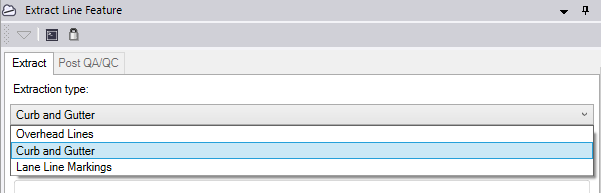

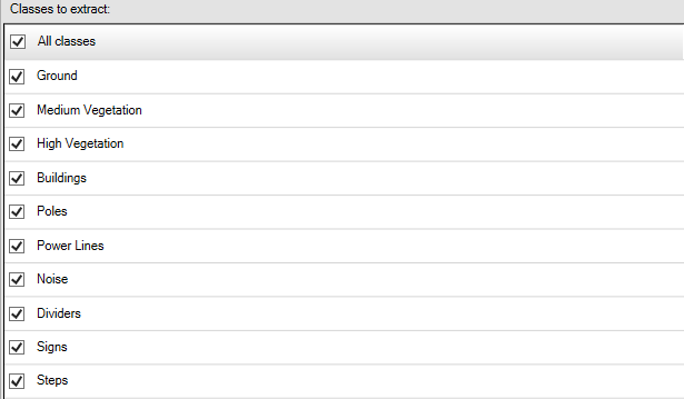

    Ian,
    I'm not sure the capabilities for classification/extraction in 2023. However, here are the "out of the box" classification/extractions for TBC 2025.20. There are also options to train custom point cloud classification models, which can help create point features with the "generic point" extraction.
    Point Feature
    Line Feature
    Generic Point Extraction
    Classification
