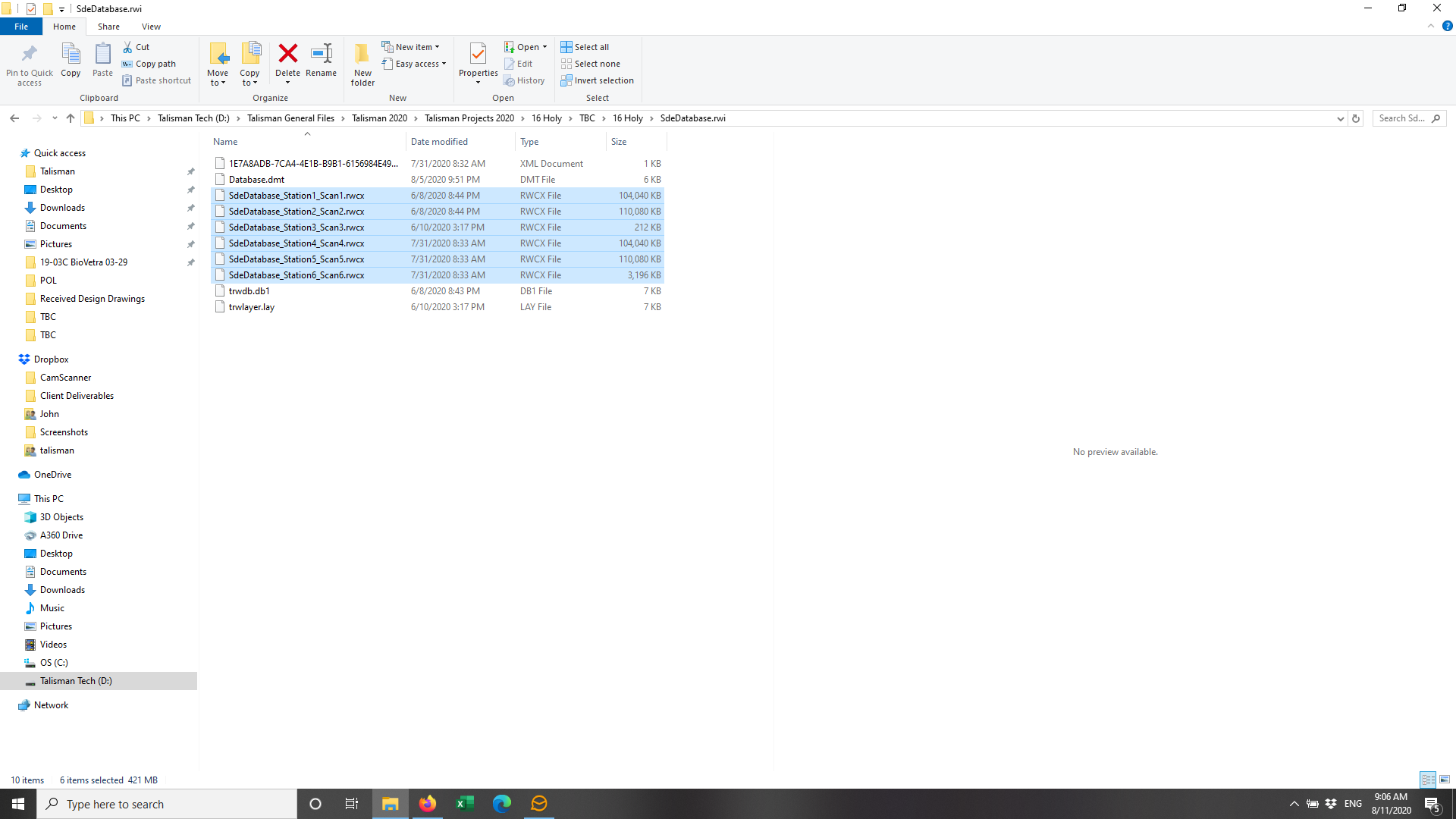

I found kind of glitch that is fixing this problem.
When you go to Point Clouds -> Register Scans you will see that your Point Cloud Region area is still missing from Reference Stations and Moving Stations BUT in Registration Results you can see that all the data is still there. And it is just somehow blocked by Point Cloud Region.
So I uploaded the raw data once again (without merging). Nothing happened. Then I Register Scans -> Pairwise -> added one scan to overall scan -> Automatically Register Pair -> Optimize Pair Registration -> Add to Reference.
Instead of just adding 1 scan station to registered scan - it restored "Default" Point Cloud Region with ALL scanned data.
Why am I calling it glitch? I am sure that someone who cleaned up Default from noise data would be upset.
