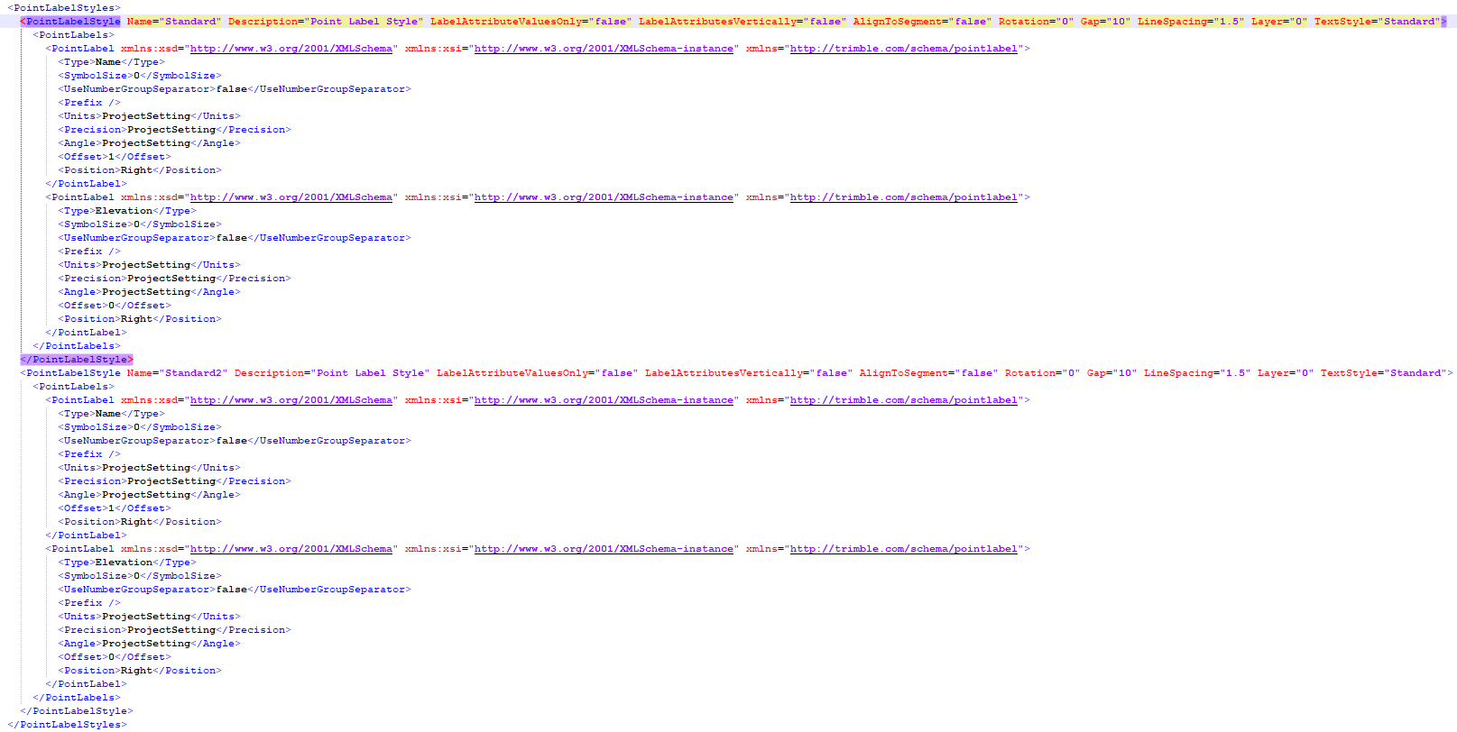

Kyle,
Thank you for this reply. I believe this is my solution.

You could export the style. This creates a notepad readable file that houses all the styles not just the currently selected one that you can then edit and then reimport. I am using notepad++ below and copied Standard and renamed the copy to Standard2. It seems like this should work for all three of the label types handled by the label style manager (line, point, polygon).

Is it possible to copy a point label style? I have created a point label style that shows the station and offset of an alignment. In this particular project, I have seven alignments. The only way I know is to create each style from scratch. It's doable, but time consuming. Has anyone found a cool workaround?
