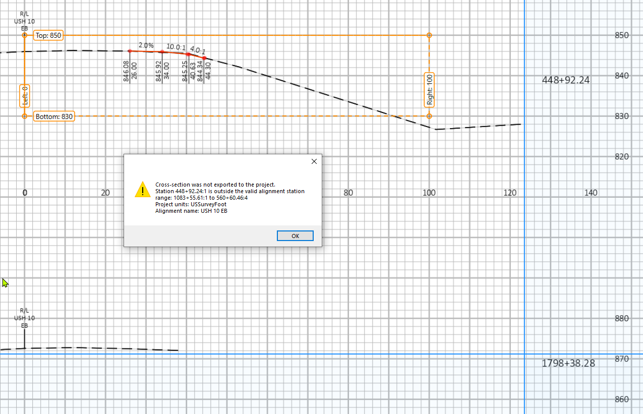

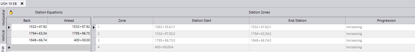

    I have an alignment that starts at 1083+55.61 and ends at 560+60.46 via several station equations. As far as I can tell there is no way to specify which alignment segment you want the digitized cross section to go in.
    As you can see below, the digitizer is trying to put it in the first alignment segment with the ":1" instead of ":4" where it should go. The station box does not let me enter ":". Am I missing something?
    Thanks,
    Joe P.

    Joe,
    I was able to reproduce and the fix is in the works. It was too late for the v5.70 release, but it will be in the release following that. I don't have a great timeline for that yet, but I will update you when it's available. I apologize for the inconvenience!
