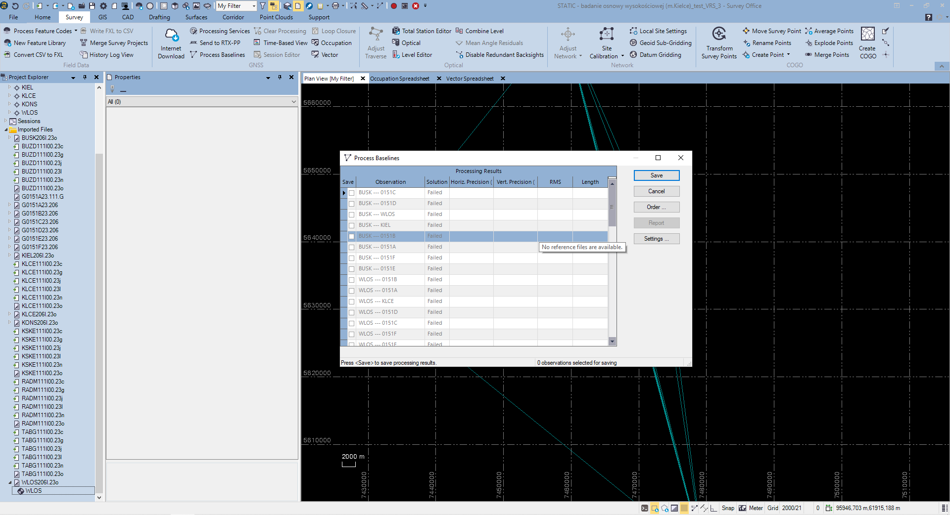

    could you please help me with processing my GNSS static data? The problem occurs when I want to process baselines. It fails because "No reference files are available". What kind of reference files are these?
    I've done that previously with a different project and that error didn't occur. I've already tried setting a new project but it still hasn't help.
    The project is attached to this post. I hope you will be ok with it being a different version of the program (SPECTRA's Survey Office)

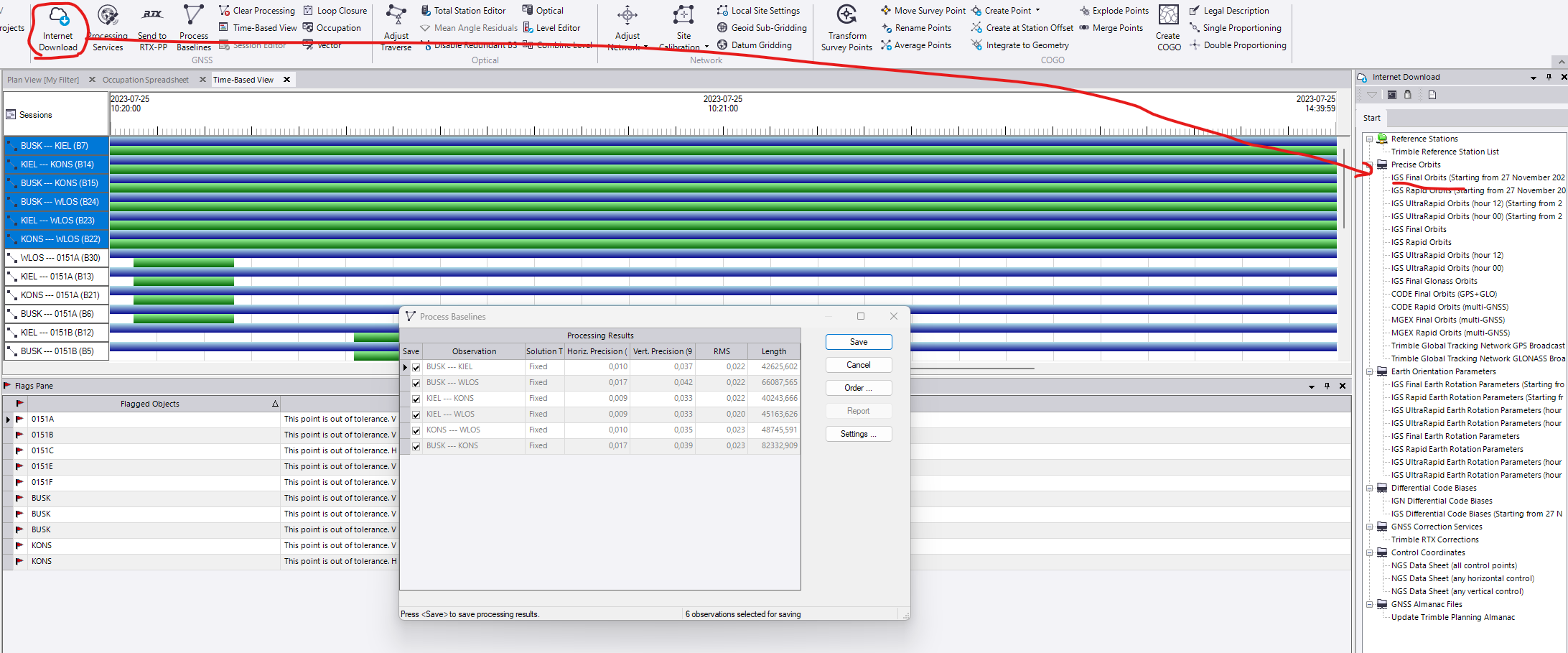

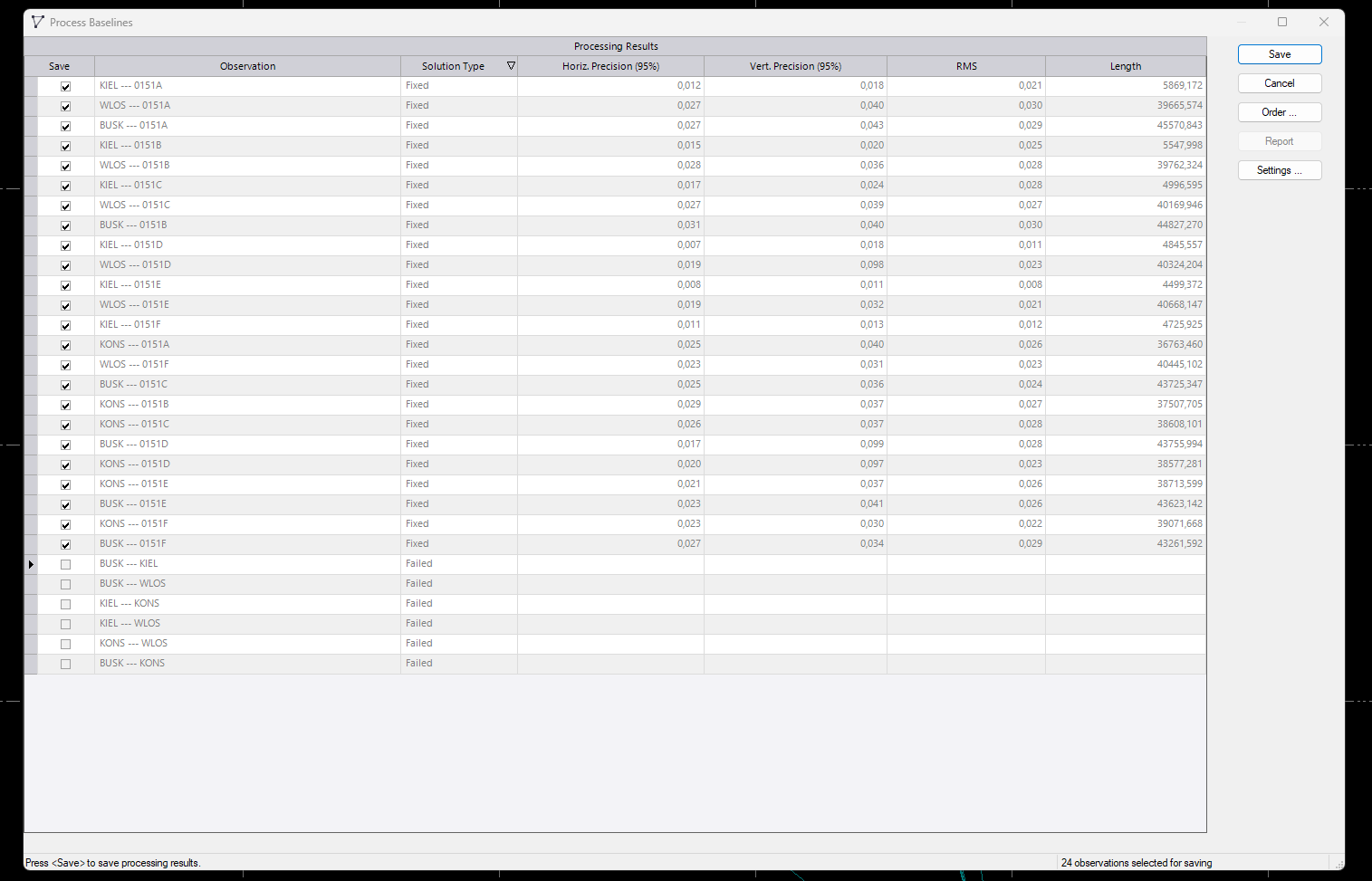

    I ran Process Baselines on your project and had issues with some of the baselines but not all of them. For me it says that the ephemeris data is not available and it's for the CORS stations I guess (BUSK to KIEL, BUSK to WLOS, Kiel to KONS and so on).
    All of the others could be processed without issue.
    So how can you fix this issue?
    Get Ephemeris data for the basestations, I downloaded IGS final Orbits with the Internet Download option in TBC and then processed the baselines again.
