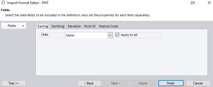

    Hello, I have downloaded the points file (.pnt) from Earthworks. The coordinates are not correct. They should be around N 2000, E2000 and El 600.0.
    Coordinates appear correct when storing. Please see attached.
    Thanks

    Looks like your looking for the files in FT and after conversion they'll be what you want becasue point files from Earthworks are stored in meters, and are Easting, Northing, Elev, Point ID, Feature Code.  You'll either have to convert the values, or use the .pnt importer in TBC.
