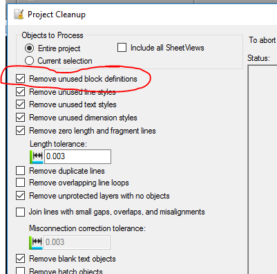

    You can purge unused blocks in the project cleanup command and a lot more.  This command is secured to data prep.

  • 9.  Re: Purge Blocks
    Posted 08-23-2018 14:04
    Yes, but I was under the impression that the Purge Blocks command is not the same as this "Remove unused block definitions" option. It's over my head at that point though!!
