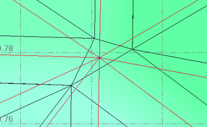

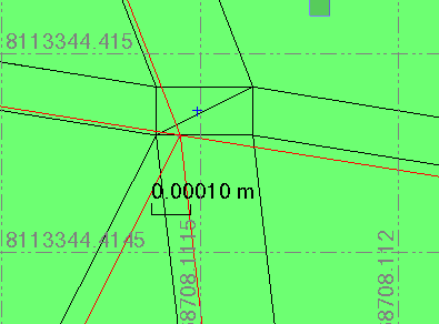

    black lines are the original triangulation, red the new one
    on very small scales the new triangulation can look a bit off, but that is a visualization issue
