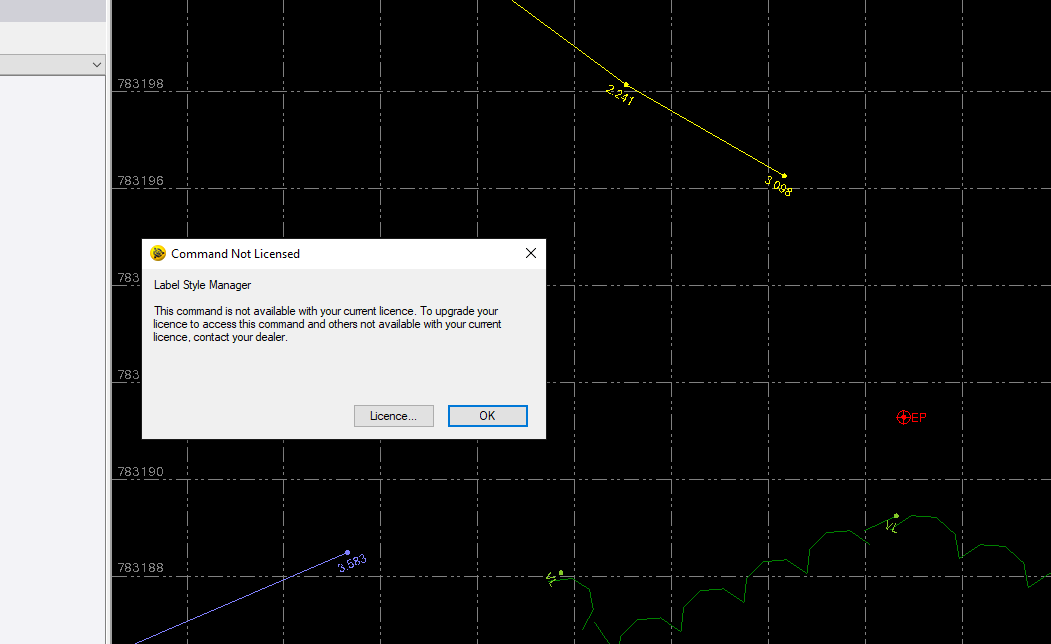

If its just for viewing, tick "Show Elevations" in View Filter Manager.
Marian

Hi all,
I am trying to display point elevations along a vegetation line feature. It is currently set to display the feature code (VL). My current license doesn't allow me to use the "Label Style Manager". Is there another way to change it so Vegetation Lines are labelled with Elevations instead of Feature Codes or do I have to upgrade my license?
Thanks in advance.
