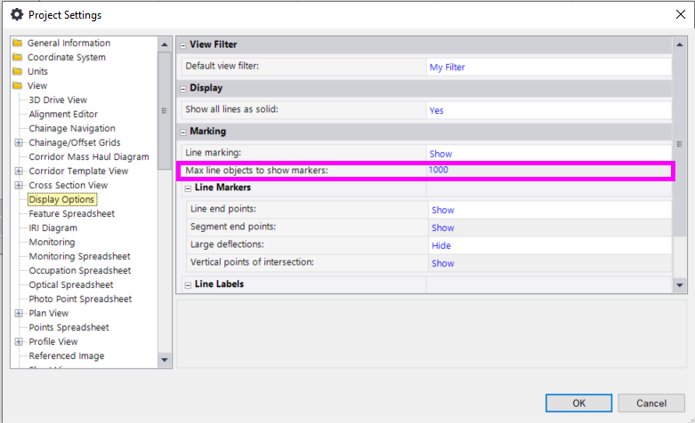

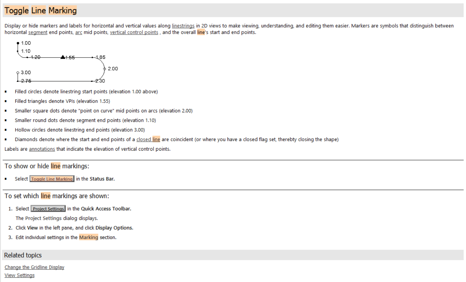

Bottom bar of screen (Status Bar).
From the F1-Help
You'll need to set the number in the project settings rather high and use "Filter Line Marking"
on the Home-Tab, otherwise not all/any lines will show markings.
