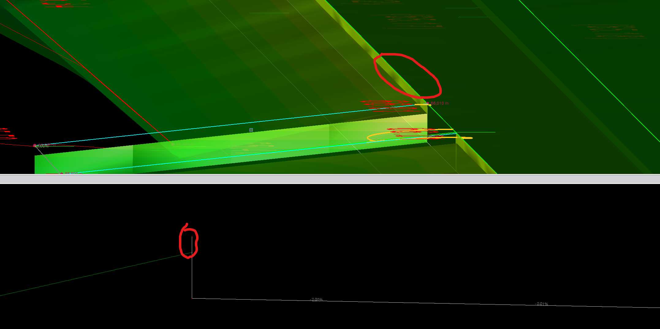

    Can I erase the walls between site improvement.
    If I create subgrade surface i get som small walls between site improvement, Can I tweak this small wall with some setting?

    I also have similar problem. After identifying site regions, validating areas and  building surfaces - FD with subgrades adjusted (the bottom surface) looks fine - no wall issue there.
    But creating subgrade (like bottom of construction layers) causes wall issue. You can check if there is small gap between site regions and identify site region there.

    It's been a while since I messed with MSIs.  I don't think there is a way now to remove the walls.  Just an extra step thought.  Export the surface as a DXF and re-import the DXF to create the MSIs.  The only way I can think of.  Unless it's a small pad. Then you could just create stringline line following the surface.

    The rockpile extract surface features command allows you to get at the internal brraklines of those subgrade surfaces so that you can fix up those issues and create a new / cleaner surface without the walls.
