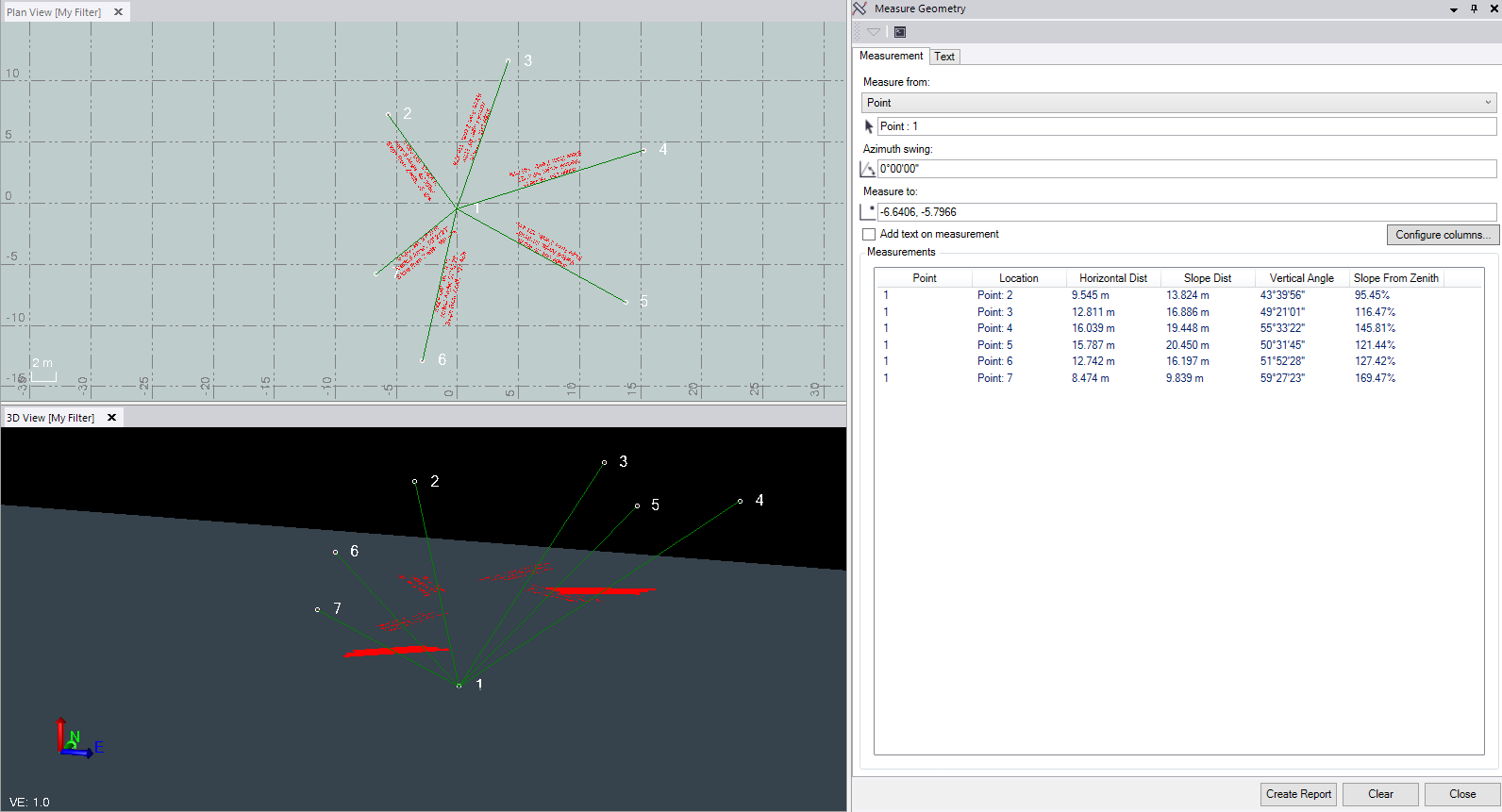

    If you are interested there is a command in the ANZ Toolbox module which will do what you require called Measure Geometry.
