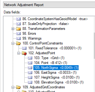

I noticed that only my Control points are showing the Sigma value. Is there a way to get this for my other points like the ALTA/NSPS report?

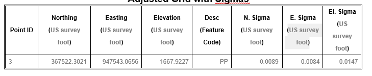

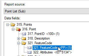

I've created a custom report that shows most of what I want, but I'm not sure how to get the feature code to display and I'm not sure if the Sigma value is 95% confidence.
Does anyone know how to get the Feature Codes to display in a Network Adjustment report from the Point List (Sub)?
Does anyone know for certain if the Sigma value is 95% confidence?

I've looked through all of those reports and I'm not really seeing what I wanted in a complete report. I'm wanting a report that after the Network Adjustment is performed, I can see the horizontal and vertical precision separated. Currently I use the ALTA/NSPS report and the point list, but the ALTA/NSPS report does not separate the precision out in Northing, Easting, and Elevation. Am i missing something in one of the other reports?
