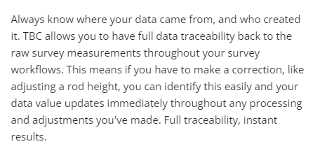

    So far, the only solution I know of is to post-process all of my data like normal in TBC, then export ALL of my sonar points as a CSV (without depths), then also export all of said points using the JRG to get my depth values which then have to be linked and corrected using some Excel wizardry. Only after all of this can I actually use my sonar data, and the only trace of how I got there is a spreadsheet. This means TBC fails at one of its own core purposes if you try to use it for projects that include any amount of sonar data:
    Screenshot from the main TBC product page on Trimble's website.
    In any scenario involving sonar data TBC fails to provide the above-mentioned "full data traceability" and access to raw data functionality.
