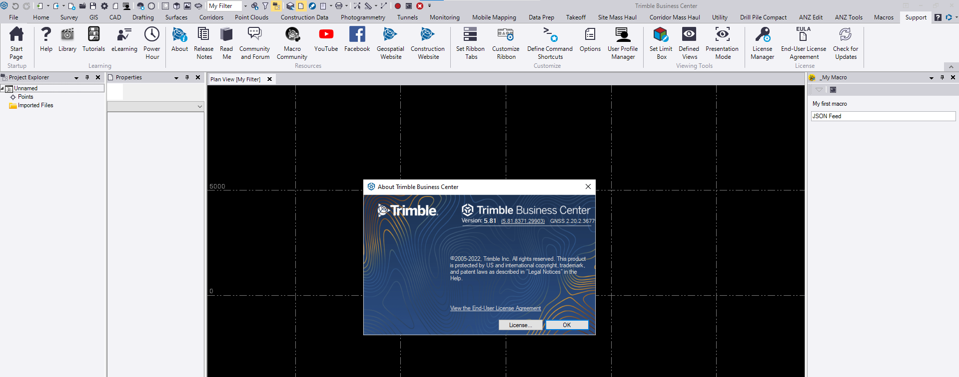

Sent: 04-24-2024 08:01
From: Bryce Haire
Subject: Supporting proxy settings and checking date from the internet
Hey Fernando,
Upcoming TBC 2024.00 has addressed the naming of the folder to the correct naming (urllib). There should be no need to either rename a folder or use the incorrect module name (urlib).
Bryce Haire

Sent: 04-23-2024 13:33
From: Bryce Haire
Hi Fernando,
This seems to work for v5.81.
import json
from urllib2 import Request, urlopen #python2
url = 'https://jsonfeed.org/feed.json'
request = Request(url)
response_json_string = urlopen(request).read().decode('utf8')
response_json_object = json.loads(response_json_string)
self.urlResponse.Text = response_json_object['title']
Bryce Haire

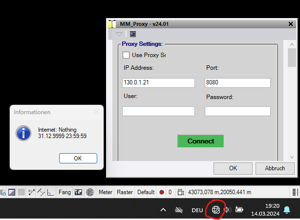

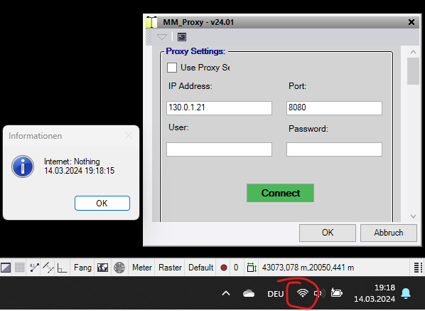

Sent: 03-14-2024 11:26
From: Fernando Calvo
Hi Bryce,
thanks a lot for your reply and infos !
Regarding IsInternetConnectionAvailableAsync(), I have tried now even some "stupid" code (especially the else as it makes no sense but just to see what comes as I got False although I had now an internet connection), that I would never use, but just to see what happens:
bIsInternet = License.IsInternetConnectionAvailableAsync()
if bIsInternet == True:
strInternet = "True"
elif bIsInternet == False:
strInternet = "False"
else:
strInternet = "Nothing"
dateCurrent = License.GetCurrentDate()
VceMessageBox.ShowInformation(TrimbleOffice.TheOffice.MainWindow.Form, "Internet: " + strInternet + "\n" + str(dateCurrent) )
And I get the following result first having a current internet connection:
And without a current internet connection:
So as my original code was assuming I´m getting back either True or False, my else was for getting False and therefore getting always False, however we are getting neither True nor False...Sorry if I´m missing or overseeing anything but I don´t understand it.
Furthermore, in my own case without proxies, if I use the GetCurrentDate(), I automatically get within 1 second the maximum date with year=9999 which is fine, however when using Proxies, it takes around 2 minutes while I can´t do anything inside TBC and apparently no timeout or too long set, and after that, I get the corresponding message.
I´m now supporting proxies by setting IP and Port, and additionally User and Password if also needed, and it works fine using the urllib, so I´ll continue from now using my own code, however it would be highly appreciated if you can check the IsInternetAvailable.. and GetCurrentDate as mentioned above.
Thanks again for your support.
Regards,
Fernando
Fernando Calvo
calvo@calvo-geospatial.com

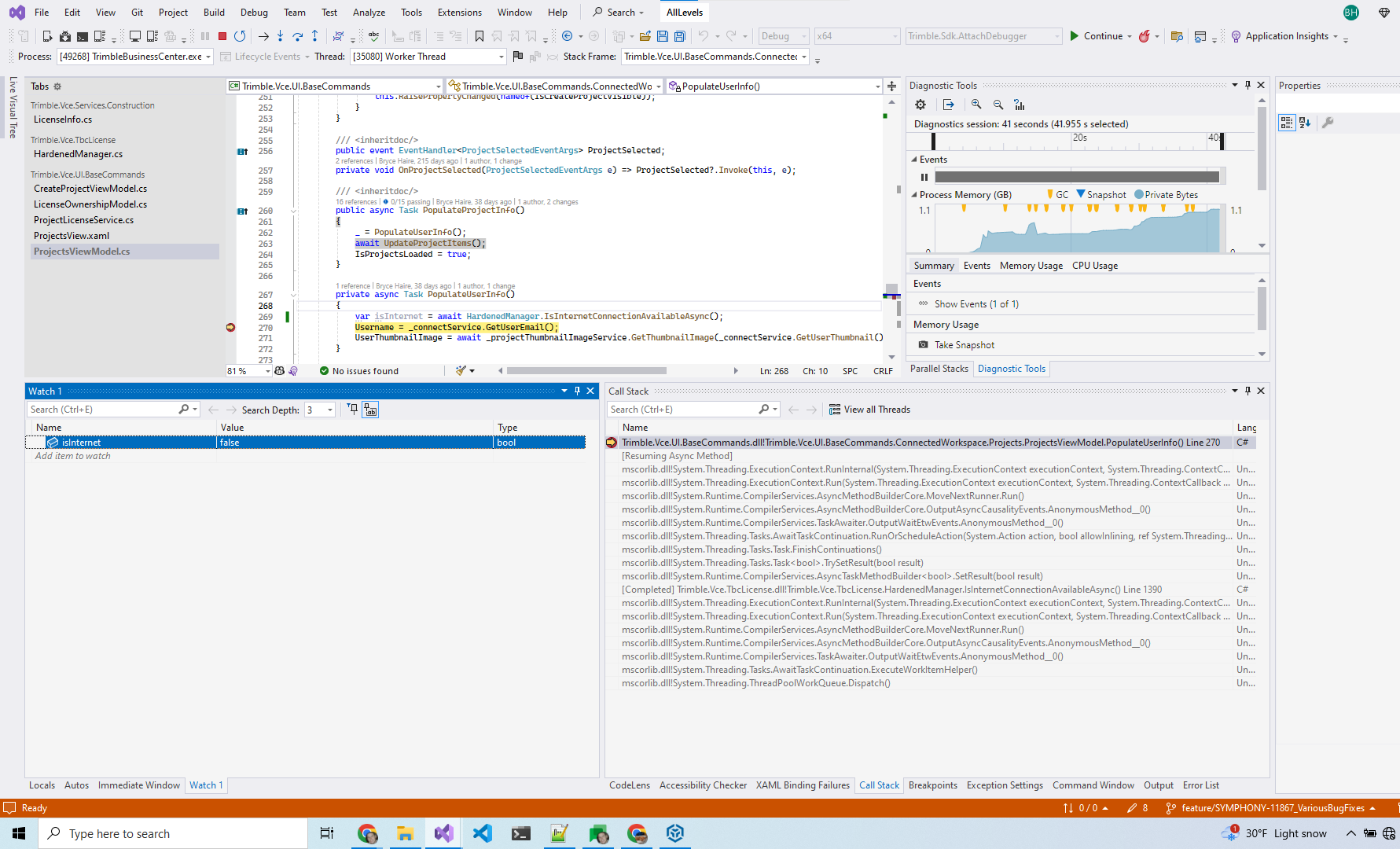

Sent: 03-14-2024 08:24
From: Bryce Haire
Hi Fernando,
Sorry for all your troubles.
For the HardenedManager, I am confused why you believe that IsInternetConnectAvailableAsync always returns true. I can confirm we ping multiple locations to determine if we have a connection. If any succeed, we return true, otherwise false. If you are offline, those calls will fail and return false.
I have taken a screenshot below demonstrating IsInternetConnectionAvailableAsync (see wifi connection in toolbar to confirm offline) and see the call working as expected.
GetCurrentDate is similar in we ping multiple servers to get the correct location. If this fails (ie offline), we return the DateTime.MaxValue (12/31/9999) as you have demonstrated in your screenshot above. I believe you misread the year value as 1999, not 9999.
I hope this helps in understanding what is happening in these calls. You are more than welcome to try to use the HardenedManager or roll your own solution with the python libraries. I do not see any glaring issues at this time with the HardenedManager and its responses.
Good Luck!
Bryce Haire

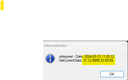

Sent: 03-13-2024 04:26
Hi again,
just a quick correction when using GetCurrentDate, so if no internet connection or not able to go through the proxies, we get back 31.12.9999 as you can see in the following screenshot and the first row showing the date via urllib:
Thanks.
Fernando
