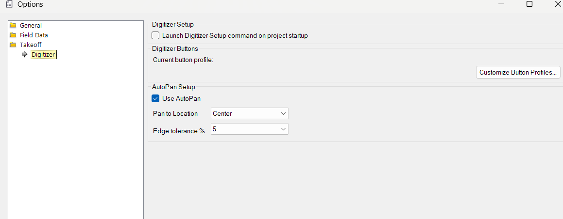

    Jake,
    Were you able to resolve this? Sorry I am ~1.5 years late here loL! There are several post going back several years on this around getting the "AOI" correct and any linestrings that may be part of your surface. See here for reference: https://community.trimble.com/discussion/takeoff-report-using-aois-vs-no-aois. It may also be worth checking the options under takeoff to verify that the edge tolerance is what you want it to be set to. See screenshot below.
    Zach Edwards
