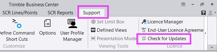

You could also try "Check for Update" on the "Support" tab, but I doubt it'll show up there.

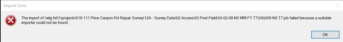

Hello, Our survey department just universally updated our workstation's versions of TBC to the newest 2023.11 and now we are not able to import our Access .job files. We have tried multiple different .job files from two different data collectors running similar but different versions of Access. One is on Access 23.10 and the other is on Access 23.00. One is a T7 and the other is a TSC5. The T7 is running 23.00 and the TSC5 is running 23.10. We get the following error when importing the .job files. See below for a screen shot of the error message. Thank you for your help.
