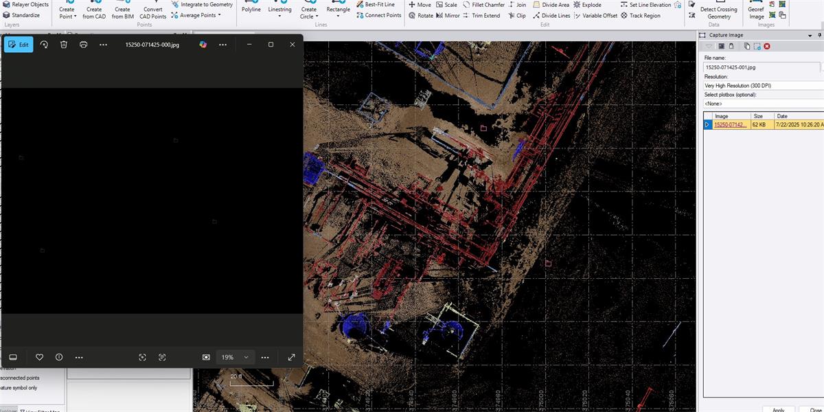

Thanks. Unfortunately, with this command it appears that I cannot make an ortho in region colors. I'm pretty sure in the past I was able to do that with the other command.

You have to use the "Create Orthophoto".

Subject: TBC 2025.10 - Export Georeferenced Images Hiccup?
Matthew Fore

Tried creating tif as well as jpg of a point cloud in plan view. Pink media file in center of screen. Images produced are all black but except I do see media folder. No point cloud. Tried both true color and region colors.
