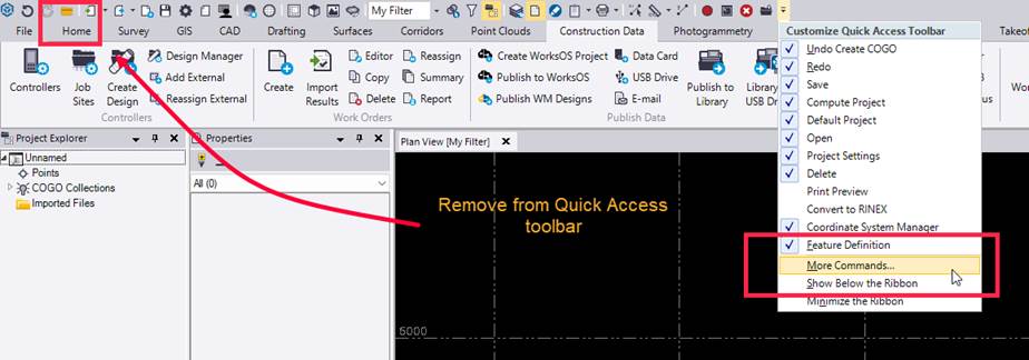

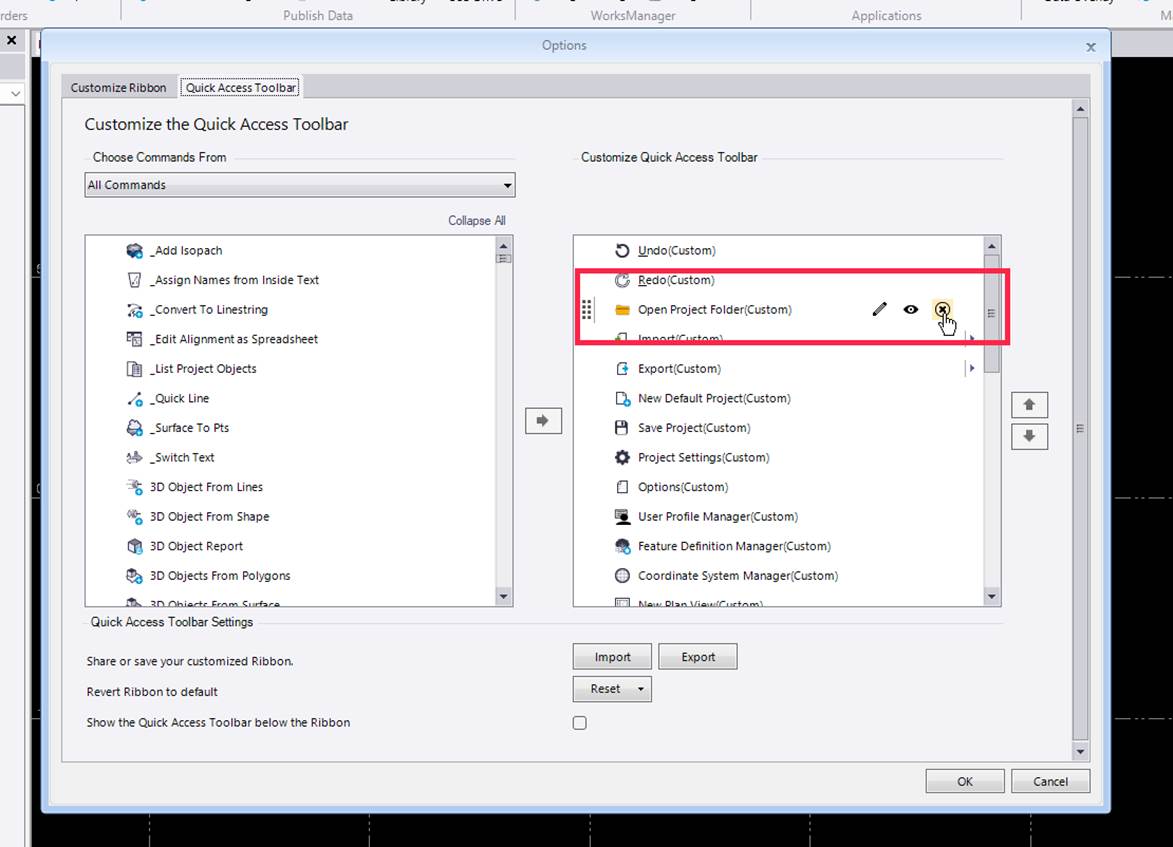

    Here was a solution Trimble had provided to someone else having the same issue, this should work for everyone. This problem only seems to happen when you are working with your files on a server.
    Step 1:
    Be back on 2025.20 if you aren't already
    Step 2:
    Click the HOME button at the top.
    Step 3:
    Click on the Quick Access Toolbar "Chevron" arrows far top right corner on the HOME Ribbon
    Step 4:
    Click on More Commands
    Step 5: (final step)
    Locate exactly the "Open Project Folder (Custom)" with the folder in front and X it out or delete it.
    Having this command on your toolbar causes TBC to constantly look to the server causing the stutter.
    Let me know if for some reason this solution ripples and causes a different problem.
    -Kyle Brown
    District 2 Caltrans
    Kyle Brown
  • 9.  RE: TBC 2025.20 speed issues
    Posted 01-30-2026 09:08
    Absolutely fantastic. Worked beautifully. Thanks Kyle!
    Eric Glaves
  • 10.  RE: TBC 2025.20 speed issues
    Posted 01-30-2026 09:42
    Worked for me as well. Thank you very much.
    Jack Thomas
  • 11.  RE: TBC 2025.20 speed issues
    Posted 02-03-2026 00:29
    thanks a lot, worked beautifully
    Max Schmuttermair
