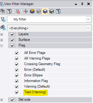

    Unless i am misunderstanding your request, you can turn off the different category's of flags in the view filter manager under the "Flag" group.
    Hopefully this is what you mean.
    Andrew Clark

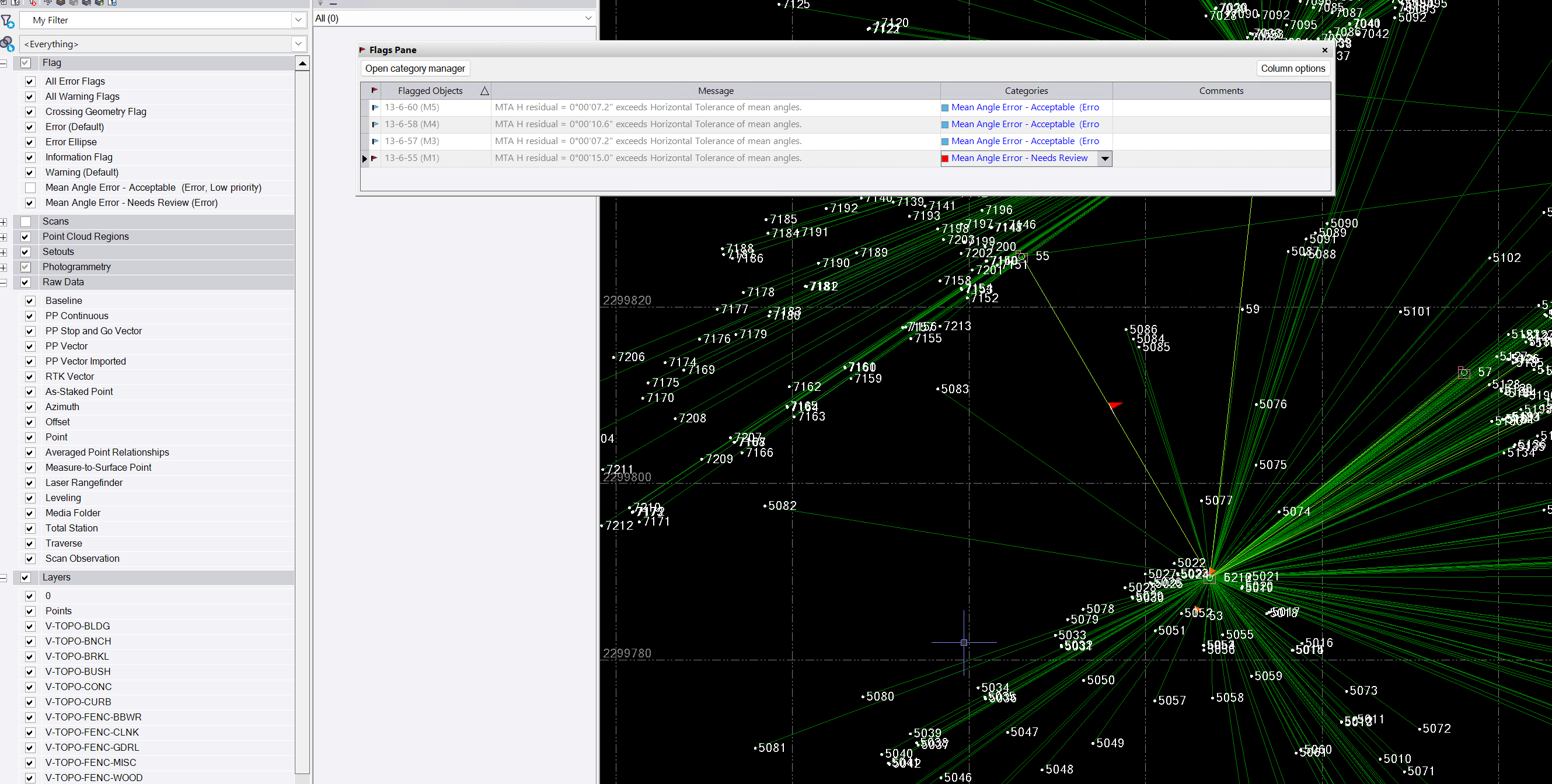

    I am aware of that added feature, and using that "hides" the flag in plan and 3d views, but not in the summary "LIST" flag pane.
    See screen shot.  Flags turned off don't show in plan space, but are still listed in LIST flag pane.
    Clayton Bradshaw
