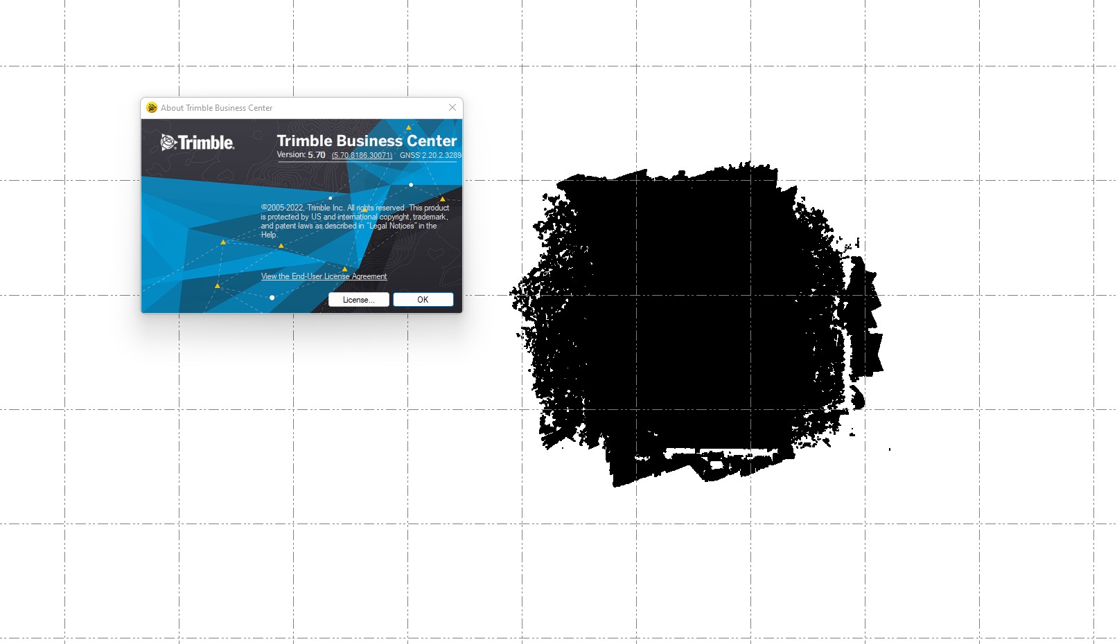

    But.....now when i open my projects ALL of my pointclouds are black, they dont have any colour at all anymore and if i do any changes it wont change. Any idea?
    Here is a video of my problem http://somup.com/c3111qtUbE

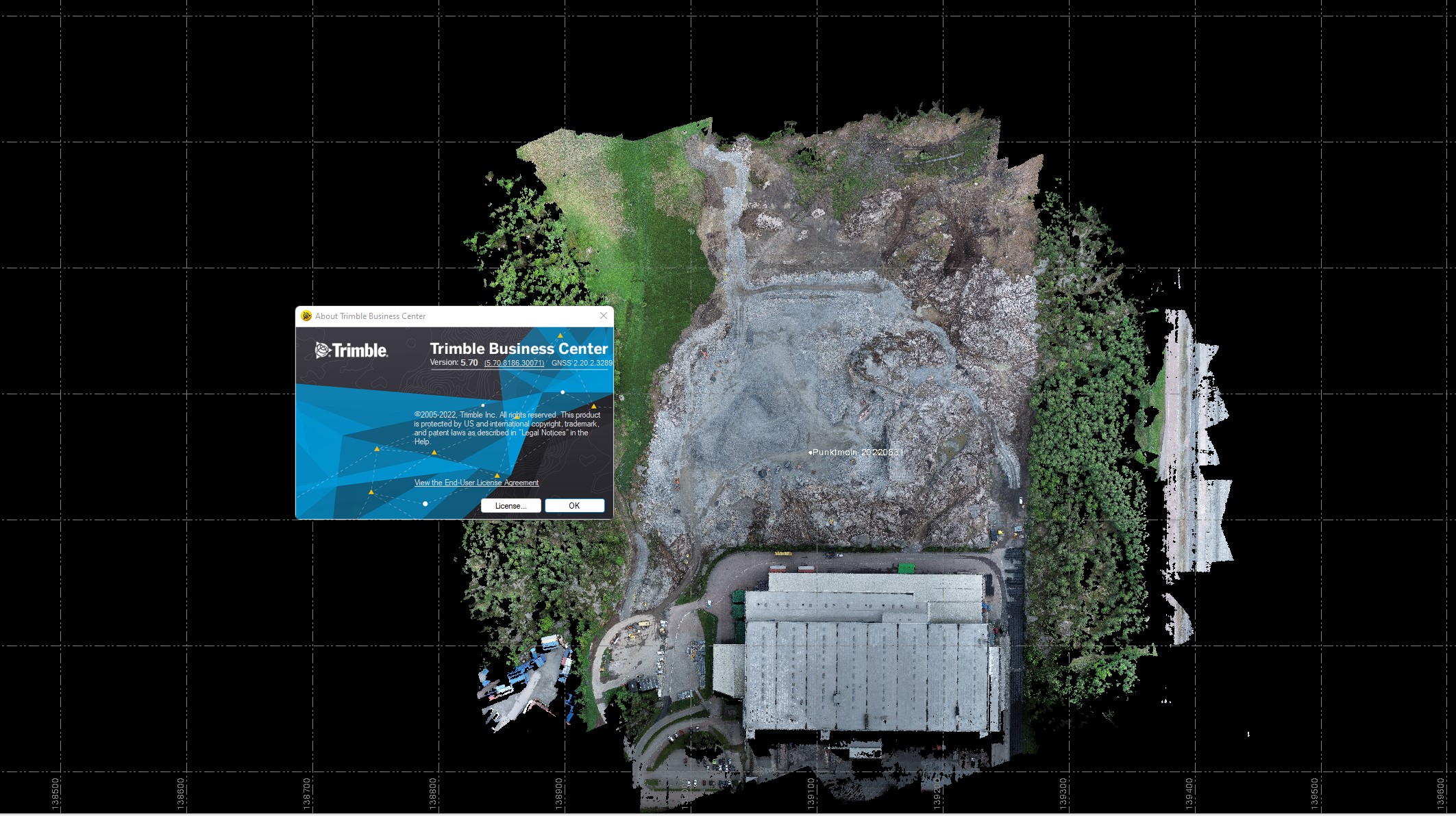

    Ok, so 1h later im back to 5.6 and now i got colours on the pointclouds again but the thumbnail issue is back of course.  http://somup.com/c311intUYo

    It works if you don't import your saved options, and just start an empty project... but as soon as i've imported my options it went black when i´m importing. so it seems like the problem is all Option based. But can´t tell wich option to change...
    Maybe the elite can figure this out. i can't attach my option file to this answer but if someone wants it just send me an email: joakim@markbolaget.se and i can send it over.

    Aha, thanks!!
    Will try that now. :)
