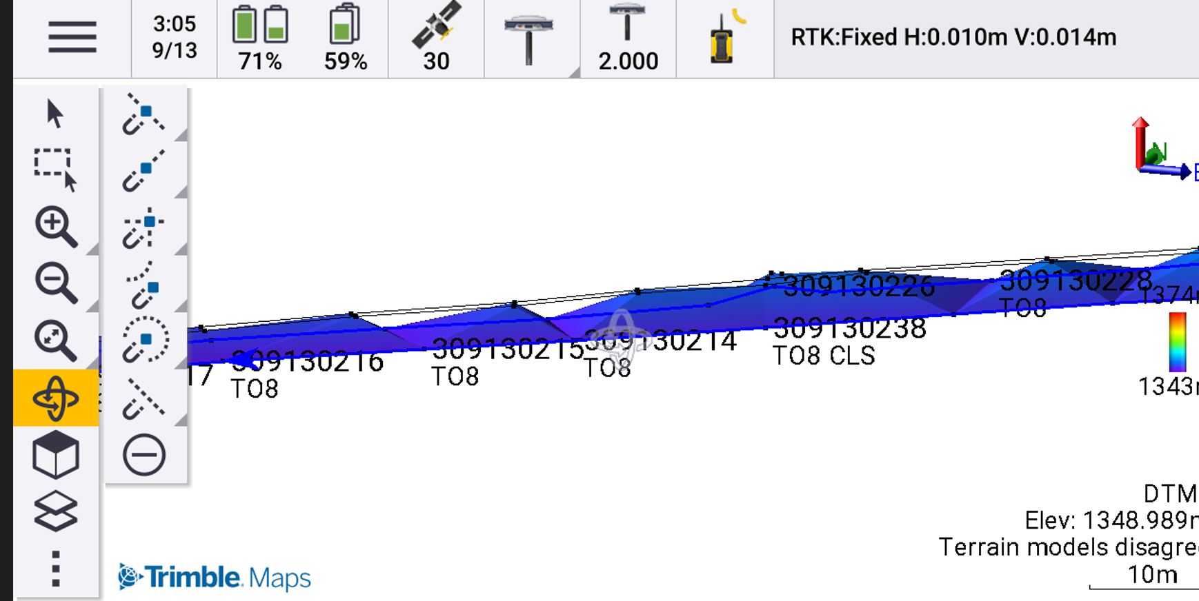

    pretty sure in access the fxl lines are not used at all, this causes a major problem in surface calculations. you can see here a long stockpile with major volume not included in the surface even though the lines were selected when creating the surface:

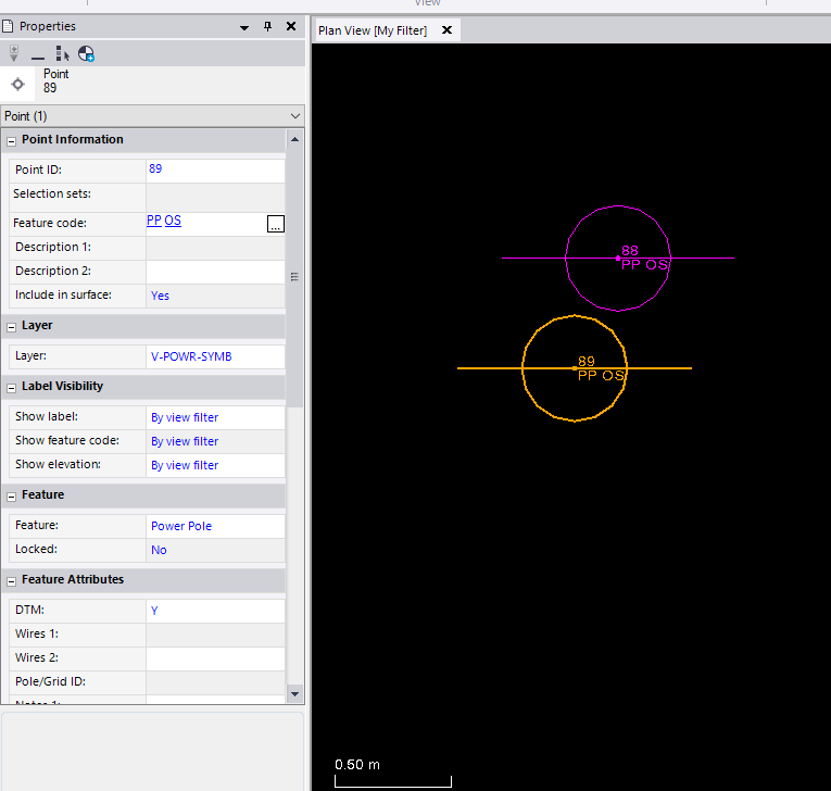

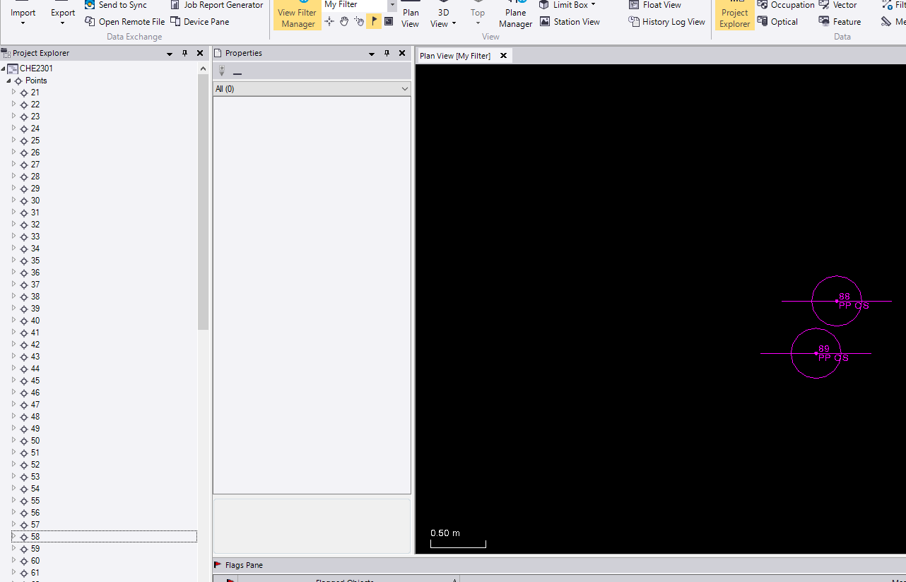

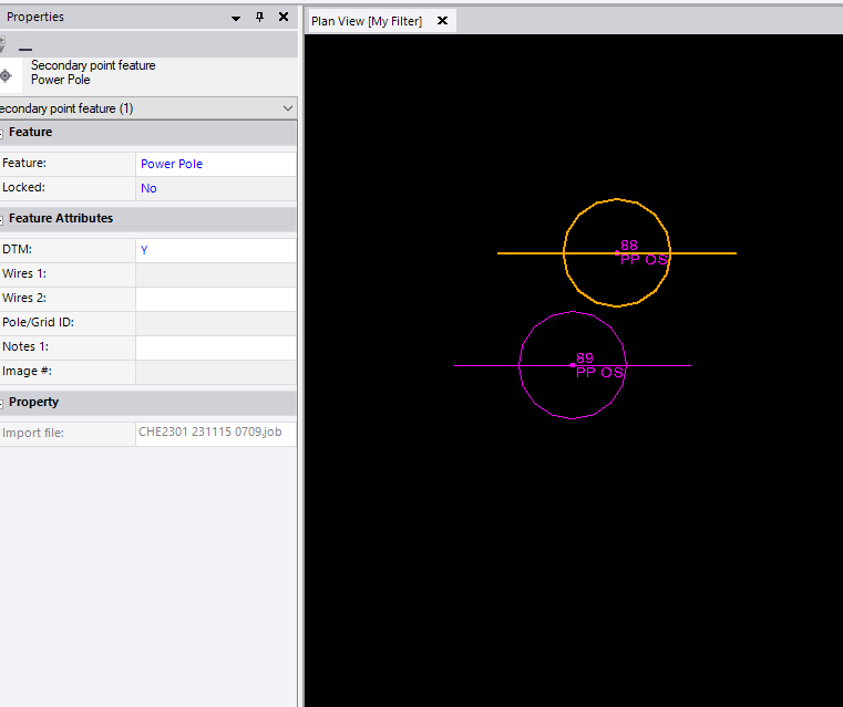

    some symbols behaving incorrectly(showing as points or as secondary point feature):
    i don't know what is going on here. i have used the same code and one symbol is drawn as a point and the other as a secondary point feature. so when i exported to dwg some symbols were missed. in both snips i have only clicked on the larger symbol and you can see that the properties differ, maybe someone knows what is going on here:
