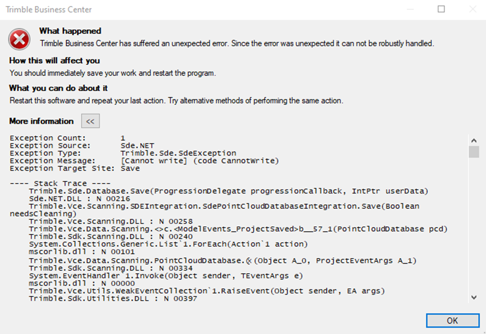

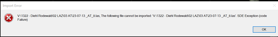

Here is the first error message you get after the import. I didn't have a screen shot of that.

Thank you Brandon. If this helps, here is one of the error messages I have received.
CB

Hello all,
The process of importing largish point clouds in .las and .laz formats has always seemed a bit buggy. It takes a long times, some times you have to kill the program and try again, etc. But I was always able to eventually get the import completed. By largish, these .las files are generally no more, or around, 10GB.
I thought I had found the reason, within the Options menu there is a location to designate where TBC shall store its temporary processing files. It defaults to the C: drive C:Trimble
Well, many times it hangs up at 96%, and never finishes, even when left for many, many hours. I imagine that means 96% is some randomly generated number. But now, I am getting weird error messages and failure to import. Of course, I can't repeat the process and get the error message this AM. But I am wondering if others are seeing this issue. I have seen in other threads and forums that the hang up at 96% seems to happen to others also.
I will post the error message when/if I get it again.
