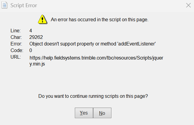

    My team is running the 2025.10 installed version of TBC.  We don't update every release, it takes to much overhead.  We have done this without error until yesterday.  We didn't install or change anything and the entire group is now getting similar script errors like the one below.  There are several of these we have to click through.  They mean nothing to me (I don't have the computer background to understand the meaning).  Is anyone else getting these?  Do you know if updating to 2025.21 would solve this, and why would that work, nothing else has changed, unless Trimble is changing stuff without us knowing, maybe like the notifications page?  I am guessing.  Thank you for the help.

    It's an error in the data that is fetched to be shown in the Notifications/News in the Start page.  Ours started happening yesterday.  Does not matter what version of TBC you are using, we have machines on 5.81 as well as 2025.20.1.  One more reason I would like the ability to not show the Start page by default.  Used to be an option in older versions of TBC.

    This is a known issue that started about three days ago. Trimble is aware and is working towards a fix.

    This was resolved over the weekend. The Start Page should be loading correctly across all TBC versions now.
