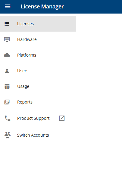

    Posted 02-12-2026 01:08
    You can add multiple users as admins - then they can claim the seat when they need it.
    Then you can switch accounts and use the admin privilege you have been delegated to claim the seat.

  • 17.  RE: TBC Subscription License for multiple users
    Posted 02-12-2026 09:07
    Sorry, Bjarke, but I believe the solution you're proposing is impractical for our situation.
    We currently have more than 40 people using TBC. Our existing setup uses a 13‑seat license hosted on a server, with licenses assigned dynamically based on availability.
    We also do not want to grant administrator privileges to all employees.
    For these reasons, as mentioned earlier, a subscription‑based licensing model is not a practical option for us.

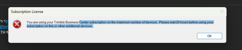

  • 29.  RE: TBC Subscription License for multiple users
    Posted 02-26-2026 15:11
    Edited by Nick McKelvey 02-26-2026 16:41
    Just adding this to the mix now as well. Maybe someone else in the team is on the license at the minute, not certain and fair enough to be locked out but to now be slapped with a 24hour ban from using the license is absolutely not ok from an operational position.
    Joe I understand the "incentives" to jump to subscriptions but as per the general consensus of comments they do not remotely come close to stacking up financially or operationally in their current form and longer term the pricing will jump back to the old costs once they lapse making it even worse.
    Sadly this comes on a day I was planning heavy usage and point cloud extractions. Lucky we still have the network license I can use otherwise either my client or trimble get the bill for the delays and downtime.
    Happily I received the 2026 Trimble Community Survey in my inbox today and will be sure to provide my feedback there as well.
