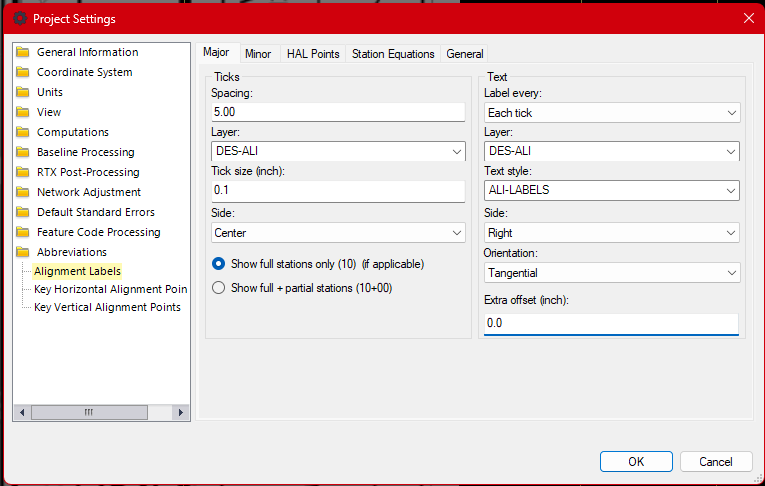

I think project settings stay in your template. So you'd just have to update your template file.

Thank you. I havent known this option. But you have toi set it again for another project, havent you? So that it would be fine to have it set in Trimble profile and could set it for any project.

Unless I am misunderstanding your complaint about alignment labels, you can just set your alignment label defaults once at the start of your project by going into your project settings.
I setup the defaults in a template years ago and rarely if ever have to change them.
