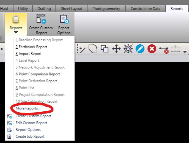

    is there a command/info to find out total length of selected linestrings in TBC?
    Thanks
    Ondrej
    Ondrej Bohac
  • 2.  RE: TBC total lenght command
    Posted 10-25-2024 05:26
    Reports>More Reports>Area/Length/Count Report
