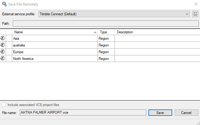

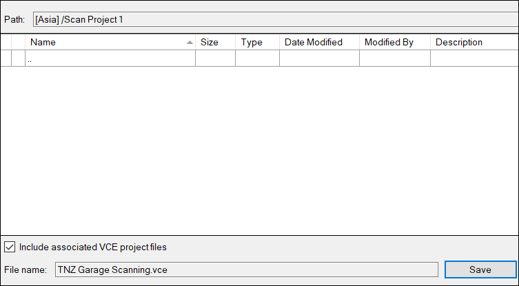

I tried myself with v5.90.1 and it is able to Save the project Remotely and Export items direct to a Connect folder now. The option to save the Project won't be enabled until you've selected the Server location and a Project folder - e.g. North America / Palmer Airport as an example for you.
I saw the same as you until I selected an actual project to save to as per below:
