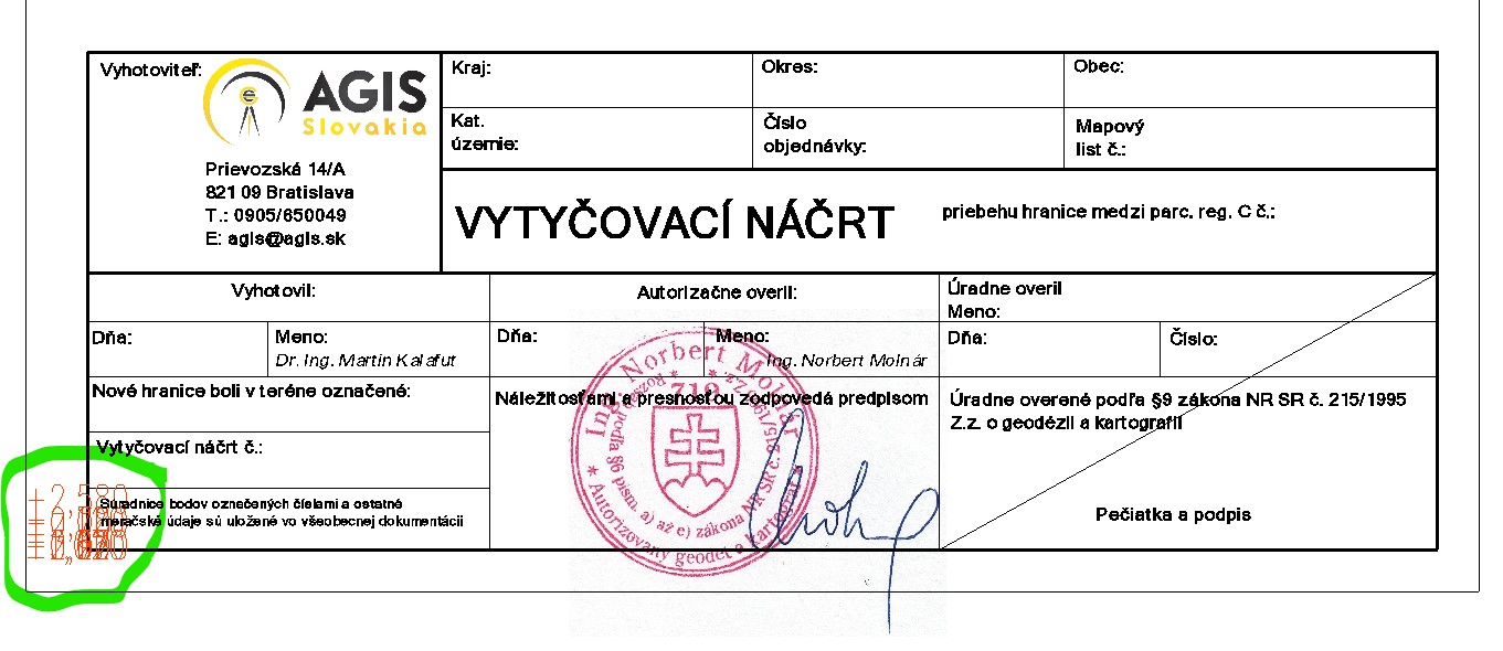

    P.S. I tried to figure out what can be a problem and found that my old VCL template had some problems in v5.70.
    So I loaded a newer one - now, it works but there is still some inconsistencies - look at the picture on the area
    bordered by green circle. I do not know, why there are those numbers. They are not present, when the template is loaded
    to v5.60.2.

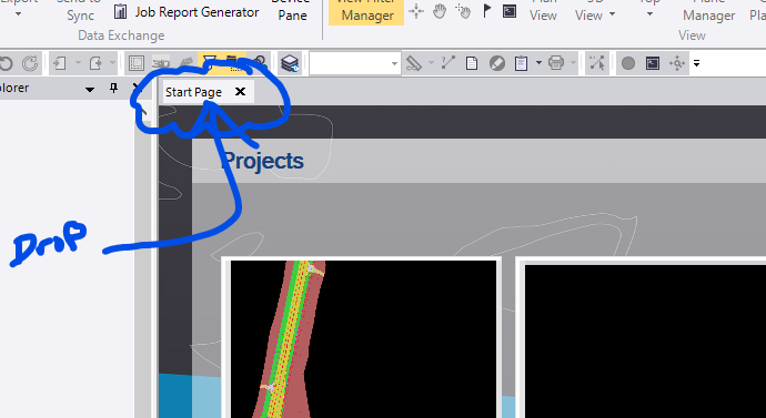

    have you tried holding the " SHIFT+ CTRL" keys while you drag and drop the vcl file of the tab?  This will allow to open older versions into new version of TBC

  • 3.  RE: TBC v5,70 - Draughting Templates problem
    Posted 06-13-2022 13:26
    Yes. But the strange numbers at the bottom left corner (as indicated in my picture above) are always present.
    If I understand your picture correctly, you show that you drop a VCL template file on start page of a project.
    However, this does not work with me. I have to drop the VCL template file onto PLAN VIEW.
    The system does not allow to drop the VCL file when pointing with cursor over start page tab,
    I have to hover with cursor somewhere in PLAN VIEW area.
    Martin

  • 4.  RE: TBC v5,70 - Draughting Templates problem
    Posted 06-14-2022 06:20
    resave a VCL of your data after you dropped into new project.  delete the extra data and then export VCL.  see if that helps.  there must be some data that is dependent of the data that your are exporting in the VCL.
