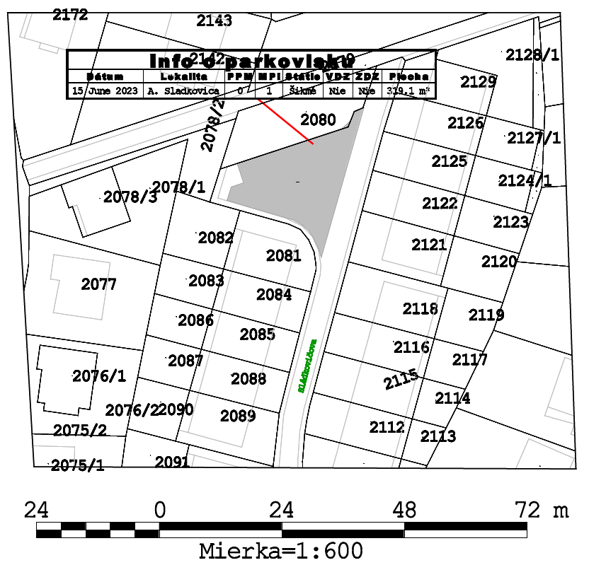

    I use a specific VCL template (I created it from scratch). When I define the area for printing using CREATE DYNAVIEW, everything looks fine
    (see picture below):
    However, when I use the function PRINT PLAN SET, a PDF file is created in which the data related to the polygon (area) of interest (the area greyed out in the picture above, precisely
    the surface area in m2 and two additional information - PPM and MPI values) are missing in the PDF file (see picture below):
    Everything  is enabled for printing (all layers) and no layer is hidden (switched off) in the View Filter Manager.
    In the Table the values come from attributes entered in Trimble Access v2023.01 in the field after feature code processing.
    I defined this in the Label Table Style Manager/Polygons and I also defined the values PPM and MPI
    in the Label Style Manager/Polygons.
    I would like to stress that in previous TBC versions including the version 5.81 everything worked problem free
    and I did not changed the Table definition in v5.90 at all.
    Has anyone an idea what´s the problem or it is a bug in the software?
