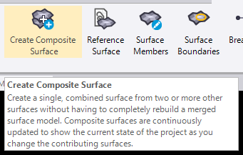

    I build mostly roadway models. Having to completely rebuild merged/combined surface was always a huge pain/time sink. I upgraded immediately after seeing the new "Create Composite Surface" function.
    That function alone has already saved me a great deal of time and headaches when revising complex surfaces.

    So, this one was intriguing to me as we do a lot of subdivisions, but our process involves building surfaces that don't overlap. I hated how difficult the merge surfaces command could be, that you always had to just separate surfaces. I guess in roadway work it's common that you have overlapping surfaces that don't have a significant grade difference between them. When you build a ramp out that intersects with mainline, usually there's overlap but barely any grade difference. Our process is creating completely separate surfaces that don't overlap for any combined surface work so that's why this command wasn't as appealing to me. Unless I'm looking at it wrong.

    The composite surface command doesn't work well with a lot of the surfaces I build as I build a lot of (almost) vertical faces and it seems to inaccurately triangulate these.
