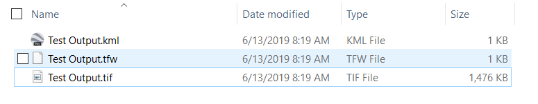

    If you use the Capture Image command this creates Georeferenced images (TIF/TFW) - we write those as TIF / TFW or JPG / JGW or PNG / PGW combinations  - these are all World Referenced Images and do the same thing - the "W" extension file is what places the image in WGS84 Coordinates (world coordinates). Most software products (TBC Included) can read these formats interchangeably - maybe DJI can do that too?
    The capture Image command allows you to select which format of data you want and it writes a KML, TIF and TFW  file as shown below
    Press the [...] button in the  Capture Image command to select the path and file extension you want to use in the Capture Image command
    Note the project needs to have a Coordinate System or Site Calibration in the project before you can capture World file outputs

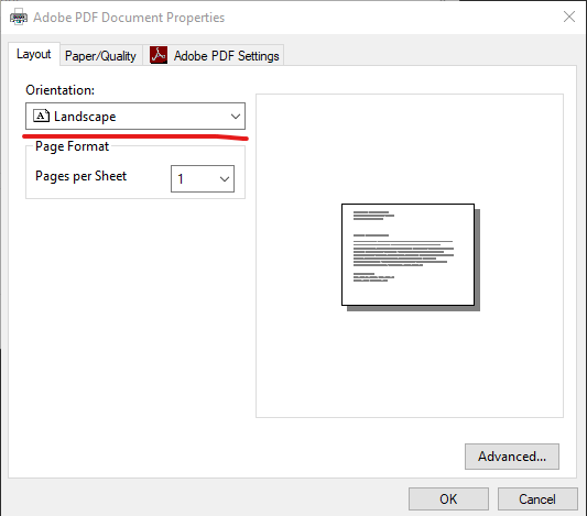

    I’ve been trying to use plotbox to create some quick visual outputs for field personnel. When setting up the plotbox, I select 11x17 sheet size. But when I print to pdf or to the printer, the product is 8.5x11. What am I doing wrong?

    When printing a plotbox there is not automatic paper size selection.
    Try the following when printing a plotbox:
    1. Click on the Properties button
    2. Select the paper size.
    3. Check to make sure the orientation is correct.
    This is the solution that has worked for me. I hope this helps.
