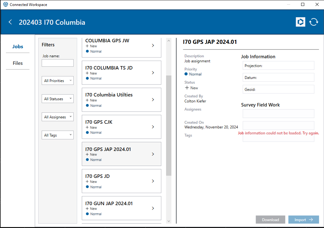

    I have a computer that is getting an error when he is trying to import a JOB file from the Connected Workspace in TBC 2024.00.  My computer is working just fine but the other one is showing this.

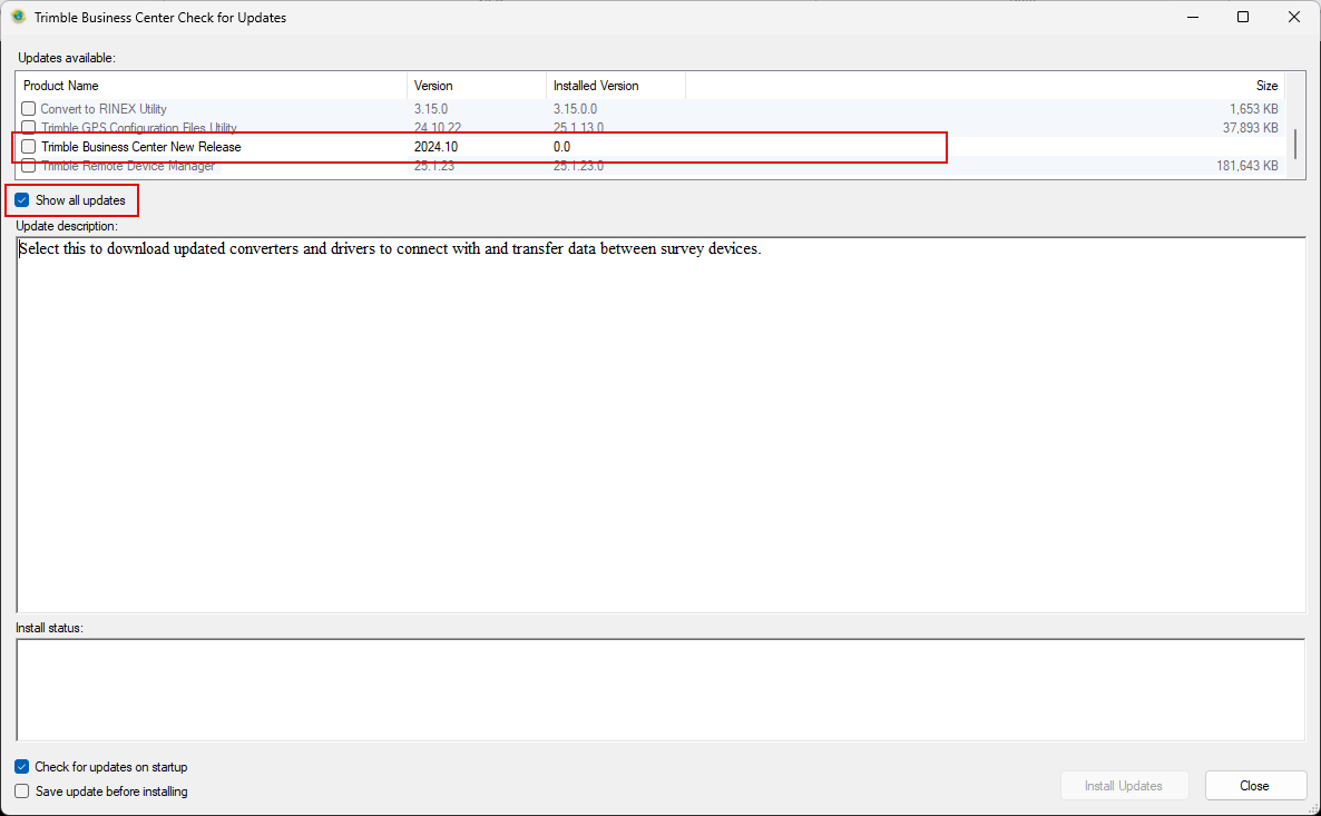

    This looks like it is related to jxl/job converters. It might be easily fixed by running check for updates within TBC. Specifically, the Trimble Remote Device manager.
