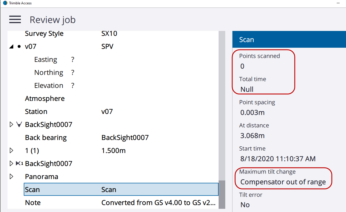

    I opened your job file in Trimble Access and see this message.
    Do you recall seeing a similar message like "tilt is out of tolerance" when finishing this scan? It seems like the scan was not completed or saved.
    I think the best thing to do here is to re-scan the last station.
    Hope it helps. Thank you.
