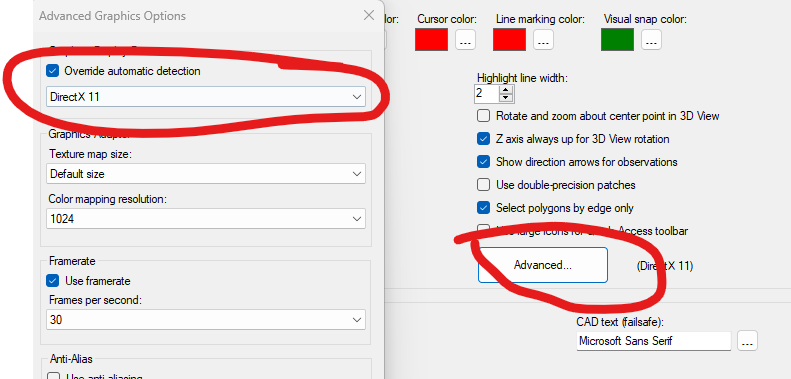

    I see 1>swale selected as selected when you hovered over it. Try changing your graphics settings to OpenGL possibly
    Suppport>Options>Display

    No luck....
