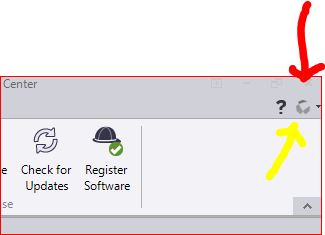

    I've not had that particular issue. However, TBC constantly signs me out. Instead of going through the settings menus, I click on the small symbol in the upper right corner (Trimble Identity) and it immediately signs me back in. You may want to give that a try. Otherwise, the installation may be corrupt.

    I did try this login button but have the same issue with it. Thank you though!
